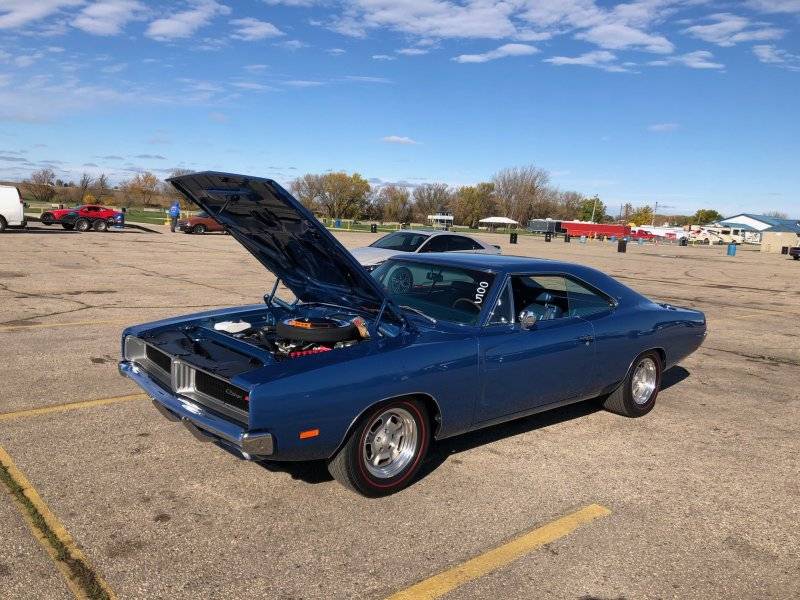

1969 Charger
4,100lbs without me, 4,270lbs race weight. 15x8 and 15x10 wheels with CR6ZZ vintage road race tires.
Engine started as a 90's "crate" 426
3.75 stroke, 4.31 bore 12.4-1 CP pistons with .043 rings GZ vacuum pump.
Milodon 31580 road race oil pan. TTI headers. Dual 3" exhaust to stock type tips.
Iron heads, I ported them. Ferrea valves, 1.4" diameter PSI valve springs. Stock iron rocker arms.
Cam motion low lash solid roller 262/262 112lsa .658 .612 at the valves.
Edelbrock 2x4 intake I converted to EFI. Holley HP efi system, flex fuel/E85. Modular/coyote coils.
Cowl plenum air cleaner.
TKO600 trans. McLeod RST clutch. S60 with 4.56 gear.
First run I slipped the clutch out at 4,200 rpm and it actually hooked but absolutely obliterated the clutch. It was slipping down the entire track and flaring on the shifts.
I let it have a good cool down and tried dumping the clutch at 3200 but it just spun. I still pedaled it and ran it out.
Shifted it normally (with clutch and lifting throttle) at 7,750rpm.

Holy sh*t that thing is making some steam. I'm getting the same 1/8 mph, but down about 4 on the top end. I'm probably 6 700 lbs lighter too.
Haven't tried the 7750 shifts, maybe that's the trick lol :eek:
