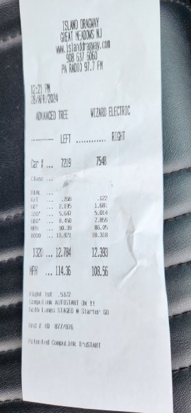

I'm in the left lane
Had another run with a trap speed of 119MPH so I think 11's are achievable
so you're saying I should go with a bias slick like a M/T ET drag slick?119 mph?!? Mid ELEVENS are definitely reachable, you've got mid elevens hp now!
You need to work on the leave with the fourspeed. You are giving up over a half second in 60 feet.
(If you don't mind a suggestion, I'd ditch the drag radials for some real slicks, if you plan on more trips to the strip. Drag radials and stickshifts don't play well together. DR'S like to dead hook, don't recover well from wheel spin, slicks can work quite well with a bit of wheelspin that your gonna get from a manual trans)
