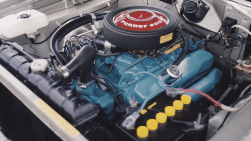

‘68 Road Runner. 10:1 451 cid. 906 heads with some work. Factory intake also with some work. Factory exhaust manifolds with port match. 2.5 X pipe to Pypes race pro mufflers. Custom ground solid lifter cam. HS rockers 1.6. 800 cfm Eddy carb. 3000ish converter by Cope. Stock 727 with shift kit. 3.91 sure grip. G70-14 redline tires. 3650lbs with me in. Full Stock Appearing in and out.
12.14 @ 112.93
Update: 12.10 @ 113.76, with worse air than my previous best. Manual valve body added with manual steering. New weight 3550 with me in.

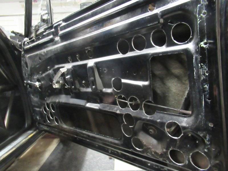

Manual steering and brakes. Radio and heater delete. No carpet backing. Lots of secret stuff.
Holley fuel matt helps with only having to run 1 or 2 gallons of fuel vs half a tank.
Pretty stout numbers. How did you get it that light?
Doug

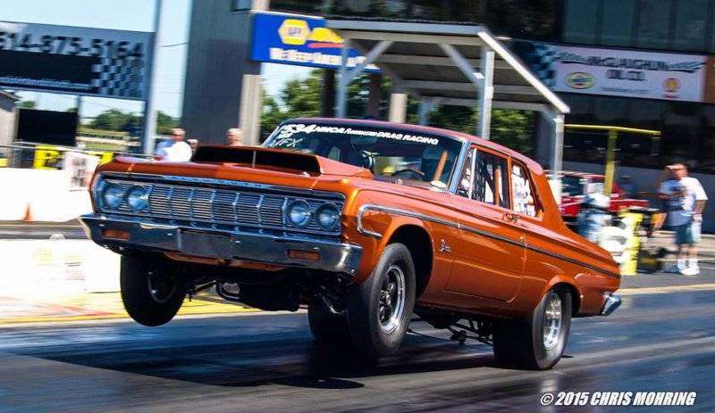

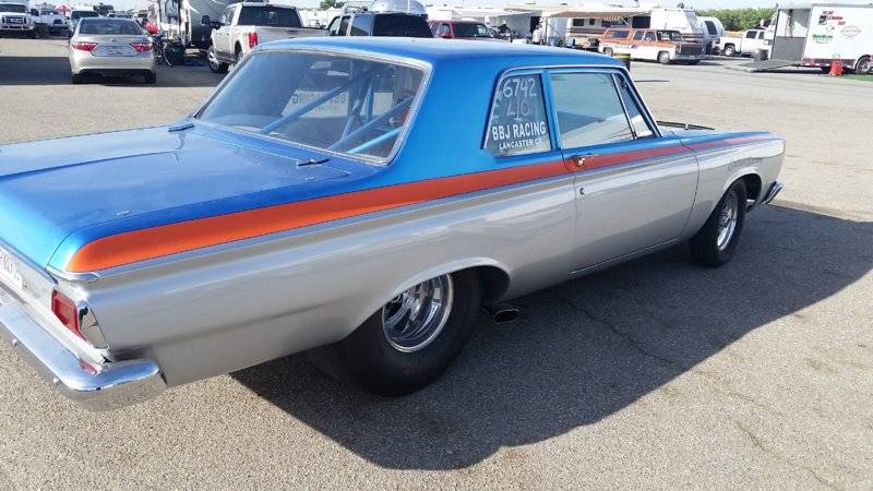

Secret stuff, ah. I'm familiar. My 64 Belvedere can get down to 3070lbs. Though to run index it normally runs at 3350-3500 (w/driver). All steel except the hood.

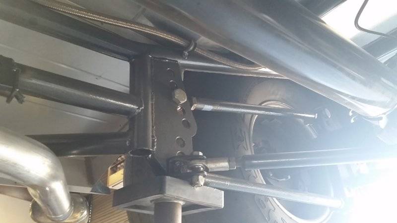

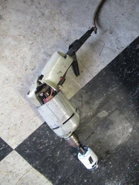

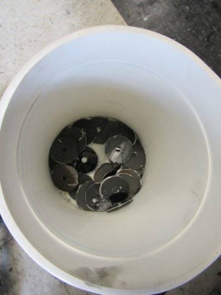

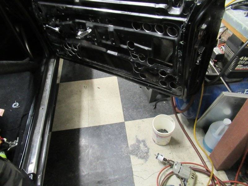

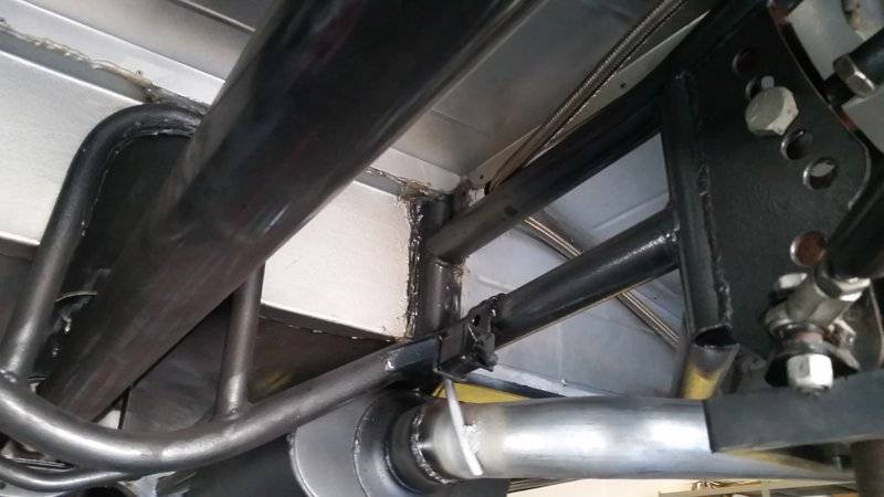

My 1965 Belvedere weighs 3050 with empty fuel cell and no driver...All Chrome Moly 12 point cage and round tube chrome moly chassis from the windshield back. Steel front and rear bumpers, only fiberglass is the hood and deck lid, all glass windows, front windows roll up and down.

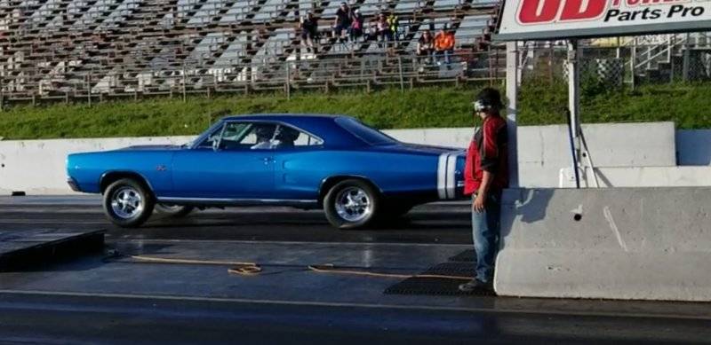

First time posting on this site but have been scouring it for years while figuring out old blue...a work in progress!!!
1968 Coronet R/T full interior (bench)
.030 '69 440
Eddie RPM heads and intake
Mild hydraulic w/steel adjustables
Pro systems Double pumper 780ish
Eddie mech fuel pump
Chrome box no vacuum 36 total
1 3/4 headers 3" cut outs into full 2.5"
Built 727 w/ 4500 and Cheetah body
3.91"s with 275 drag radial(5600 trap)
Mopar stock replacement leafs stock snub
Gas shocks and sway bar out
Best last week [email protected] with 1.77 60
