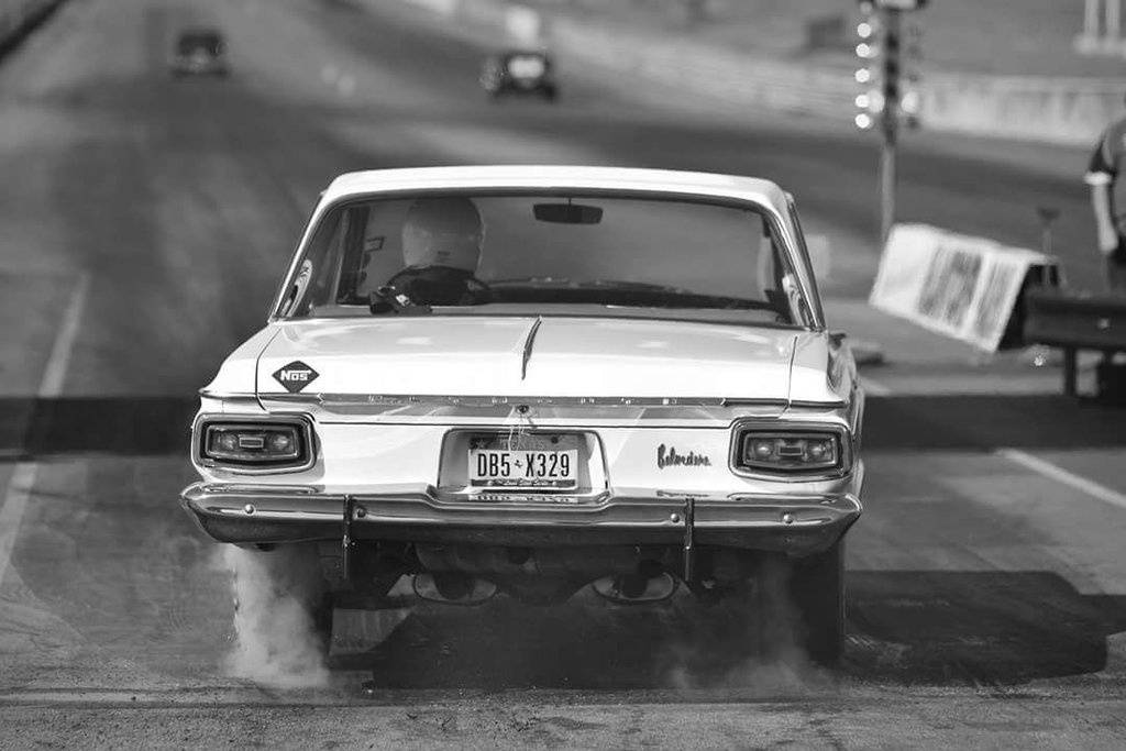

Combo:
64 belvedere all steel with bench seat
75' smog 440
Cast internals 8:1 comp
Comp cams xe284h hydraulic
452 template ported by me and 3 angle valve job, stock valves
Speedmaster China junk ss roller rockers
Edelbrock rpm intake
NOS sniper plate kit
Quick fuel hr 850 dp carb
70s dizzy and msd 6a
Ngk 7s pluggs
Headman headers and 3" exhaust
2 chamber walker mufflers that neck down to 2 1/4" internal
727 with tf2 shift kit
Hughes 3000 stall converter
8 3/4 rear with 3.73 gears and limited slip
26/15x10 slicks
2 day event with 2 different tracks.
The cars had to be driven between the tracks via checkpoints just like hot rod drag week (only alot smaller) . About 300km
Had a old Swedish one wheel trailer behind my car
View attachment 492198 View attachment 492199

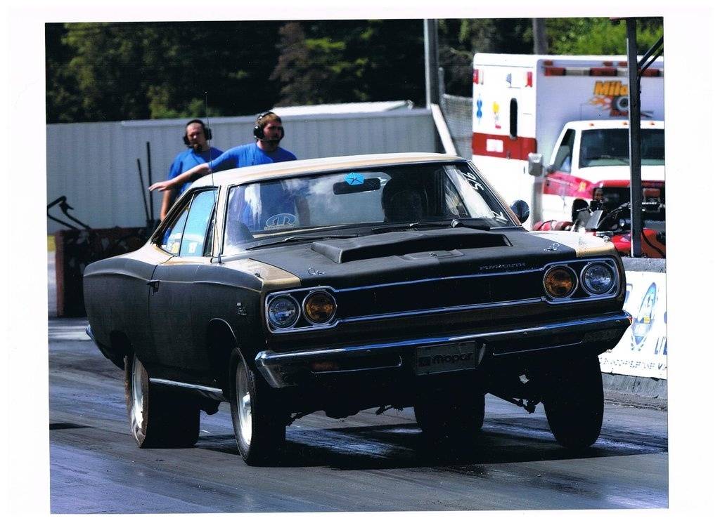

Have only run 1/8 mile so far but here is my combo:
65 bel 2 full interior, all steel.
440 .030 over 10.1 icon Pistons
Bullet cam 490/492 lift 235/239 @ .050
Street dominator/ Holley 850
Trick flow 240 heads, stock stroke
727 with 3200 ultimate converter with reverse valve body
Dana 60 with 3.54 gears
2" TTI headers and 2.5" exhaust to rear bumper
7.80@90mph. Should equate to 12.15ish, I believe.
Installing exhaust cut outs soon, hope to open it up and run in the 11's soon!
