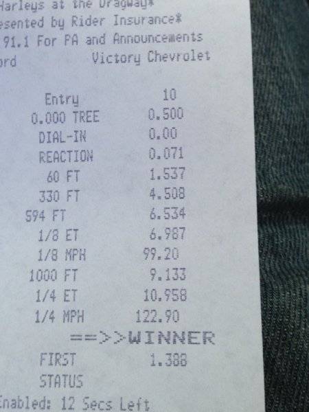

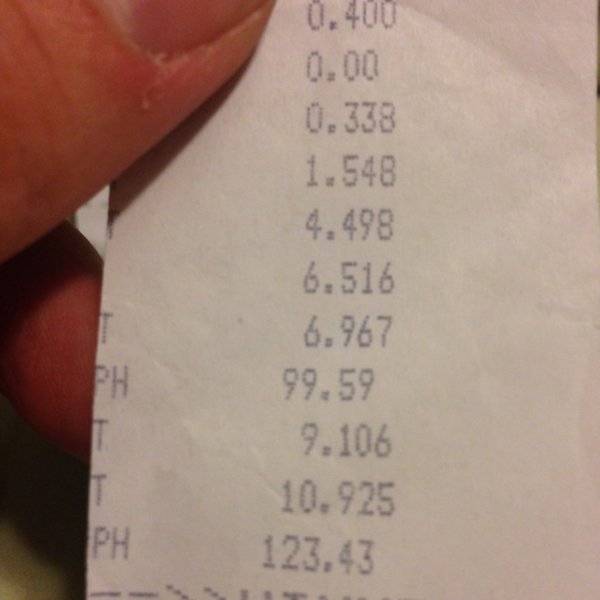

400/511
72 400 (630 block)
511 source kit -24cc dish .035 over
Positive deck +.010 / .051 cometic gaskets
Indy S/R's ported by MCH. 75cc chamber (standard port window)
COMP SFT 260/266 .390 lobe lift on 110 in @ 106. Nitrided
1.6 Indy rockers
Milodon 7qt pan with 1/2" pickup
TTI step headers the 3" TTI exhaust & 3" delta flows
Source girdle with stock caps
727TF
T/A valve body
Billet steel drum
9 1/2 " Tci 4700 flash
69 road runner 3760#
Over 4g with 240# driver
Stock suspension with old GTX Leaf springs
Frames tied
4.10 Dana with original trac lock and 23 spline axels
Summit drag shocks on rear with home made snubber
Worn out shocks on the front
All runs were driving to the track and running air cleaner, mufflers, and no tail pipes.
Six pack with 500 cfm center
Ported TM6 with 1050AN proform carb
1" spacer
Head flow sheet
Broke the TCI converter. Went to a tighter PTC, flashes around 4400. Slowed the car down slightly.
I did make 1 pass with a turbo action J Converter back in the spring. The car left super violent and actually felt weird so I peddled it once. Still went 10.95 but look at the 60! The vert was very fast but I didn't like it for driving around. I only got 1 pass that day due to rain. I'm pretty confident I would have seen some .80's had I made more passes.

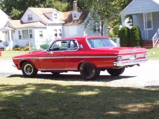

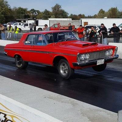

I think you know most of mie as its pretty close to yours on my 63 Sport Fury.
440/493
1970 440 block
440Source 4.15 kit with crank , rods , pistons , rings and bearings
D-dish pistons for 10.6 comp .006 down, has .045 quench with .039 head gasket
Indy S-EZ heads , flowed @ .600 lift 329 intake....223 exhaust
Main studs and billet caps
Dwayne Porter solid flat tappet cam , 264 & 270 @ .050 , .585 & .592 lift , 110 LSA on a 106 ICL
Hughes 1.6 roller tip rockers
High volume oil pump and Moroso 7 qt pan
TTI 2" headers and TTI full 3" exh to rear bumper and Dyno-Max Ultra-Flow mufflers
Indy dual plane intake and Holley 850 DP
727 with bolt in sprag and Turbo Action reverse manual valve body
Dynamic 9.5 converter with 4200 flash
6 point rollbar & frame connectors
8-3/4 rear with 4.30's and Detroit Locker
3400lb Super Stock springs and ext rear shocks
CE 3 way front shocks , all other suspension stock
Car weighs 3725 lbs with driver
30 x 9 Hoosier radial slicks
Car is driven to track and raced through the full exh on 92 pump. In fact I have never uncapped it or had race gas in it. No adjustments done at track as its raced just as I drive it other then I took the small air filter out.
Best of 10.76 @ 124.49. Its run 10.76 four times as I have not made any changes to it since I built it. Only thing I did was bolt on my buddies 950 Proform and the car ran the same mph and et. Ron

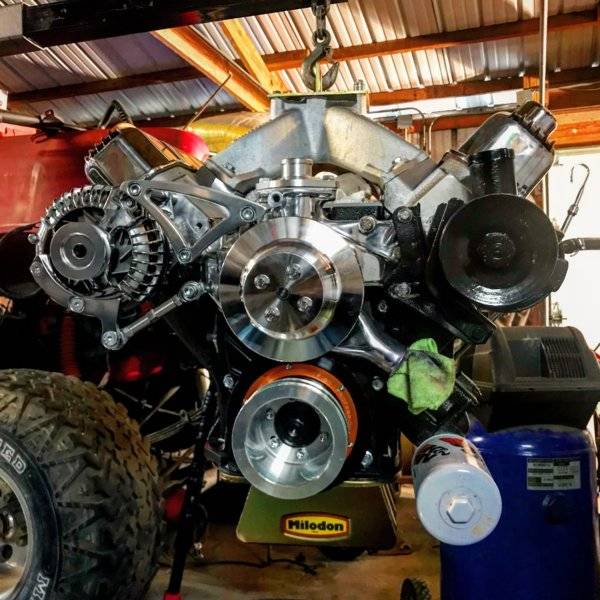

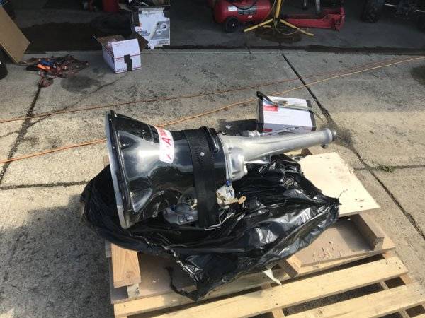

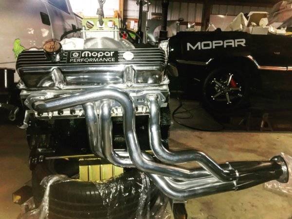

This thread needs/deserves a lot more attention, it has sticky potential if everyone running strokers chime in. There’s always people asking about stroker combos. I’ll list mine below.
I don’t have any dyno or track numbers to report but maybe you guys can take some guesses on HP and ET in a 67 coronet let’s say 3600lbs.
440 stroked and poked to 505”
12:1cr
Eagle crank and rods
Mahle power pak flat tops with 8.0cc valve reliefs
Comp cam .693/.694 263/270@.050
T&D 1.6 ratio roller rockers with oiling upgrades
Edelbrock Victor max wedge heads OOTB porting,
Ferrea valves.
2” TTI headers
Fitech 1200 fuel injection
Edelbrock super victor intake
BAM Roller lifters
Milodon 7qt pan
Milodon pickup
Felpro .039 Head gaskets

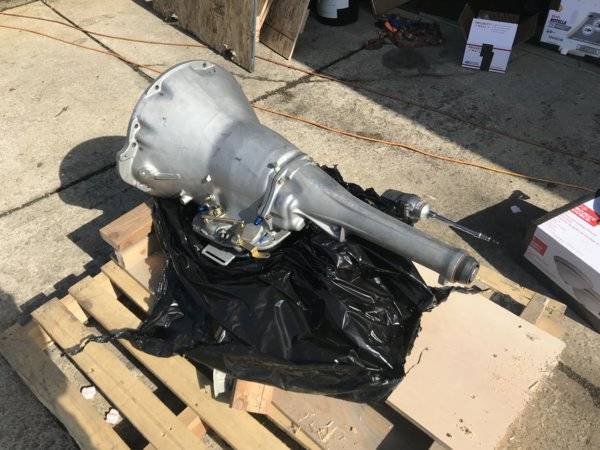

Trans is from A&A, their super competition trans with a brake and all the goodies 5000 converter

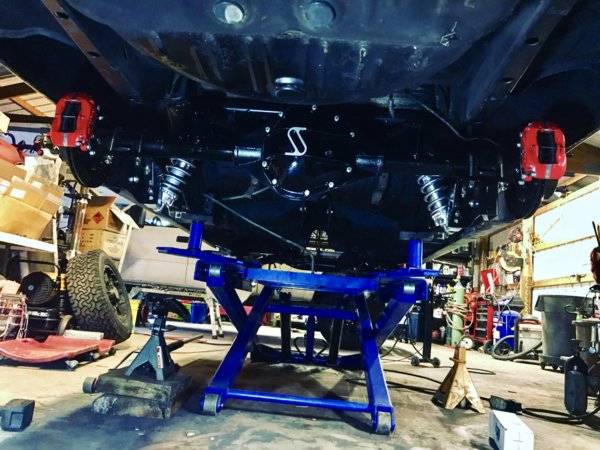

Rearend is a strange s60 with S trac differential and 4.10 gears and 35 spline axles

That's one super fine Coronet you have ! And that combo sounds like it should hit 9's when its tuned in. Good luck with it. Ron

Should fly, I bet it runs 10teens/twenty’s pretty easy! May have to work a little to widdle it down from there.
