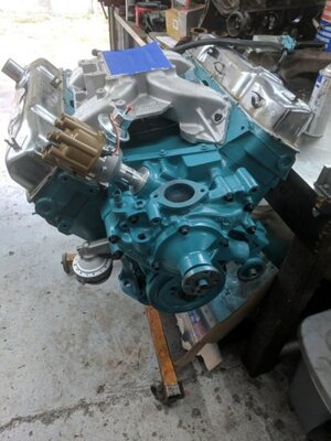

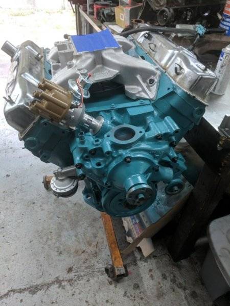

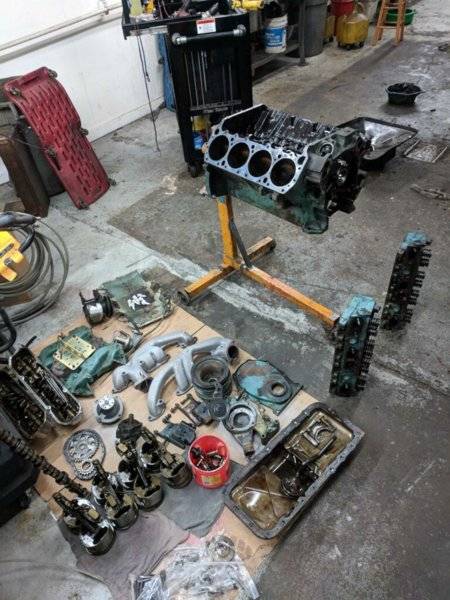

67 GTX. This build is currently fluid. I'd like to say we are shooting for 500 ish HP and 9.5 Compression or higher.
Just sent my 915 heads off to Hughes Engines for porting and machining.
The plan is for a street sleeper to keep as close to looking stock as possible.
The additional plan to date is:
Block should go in next week for machining and sonic
505 Stroker Kit from Hughes
This time going with Hughes recommended Cam and Torque Converter
Holley Street Dominator Intake (hood clearance concerns)
Holley 850
Sticking with Exhaust Manifold (looked great when we pulled)
727 rebuild with shift kit
Gears 3:55

Well we are making progress. See attached.
Will be adding a Holley 770 instead of 850.
Torque Converter will be a 3000 stall. It's down to either Hughes or PTC.
TTI headers.
Sticking with the factory look 3 core radiator.
Went with the 6 quart Mancini oil pan.
My question is do you think I will need a transmission cooler? It will be street driven and at times sitting in traffic.
Thanks.

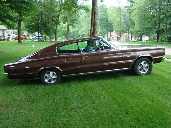

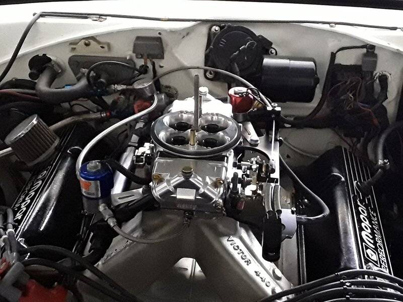

67 Charger 4232lbs full street trim 440 / 500
727, Billet Front Planetary (Bob Grant, Australia built. 3500 stall
Hughes Stroker short block with Girdle 11.5-1 comp
SLD FLAT TAPPET CAM 268/272
Edelbrock RPM Heads Un-ported
Edelbrock Victor Intake Un-ported
Rayje Bx4 Billet 1050 carb
8.75 rear 3.90 gear
pump 98 fuel
150 shot NOS
best time on MT 295/55 -15 drag radials 10.8 @ 126mph 1/4 mile (Willowbank Raceway)
Best time on 295/50-15 Street tires 6.82 @ 104.3 mph 1/8 mile (Willowbank Raceway)
20211107_114504.jpg carb pic.jpg 67 Charger side.jpg 67 Charger rear.jpg TOY440.jpg
A very nice TOY there Duncan!
I guess the Victor intake and the 150 shot of NOS has given you a BIG hit in the 1320, coolio...:bananahit:
I thought the 67 Charger were much lighter than that?
