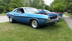

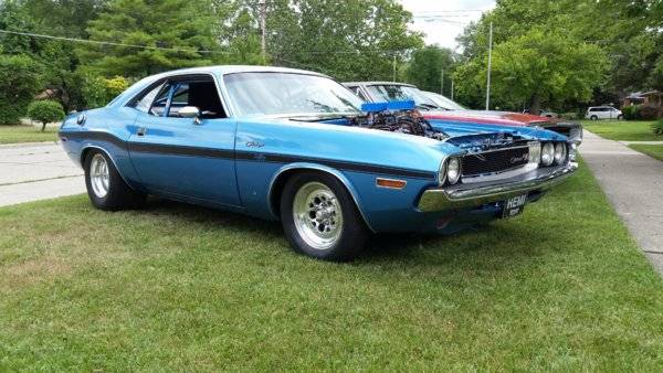

Here's mine
400 low deck stroked to 500" 4.375 bore 11.5 compression checked with a whistler
Wiesco flat tops w/ valve reliefs,K1 rods h beam rods and scat 4.15 crank.
Mancini girdle, milodon tray and 7qt pan
0 deck height, cometic mls .040 head gaskets.
Doug 451 headers.
3" exhaust x pipe dynomax ultra flows, 3" tti tail pipes.
Qa1 upper and lower control arms
tubular k frame with struts all Qa1. Moved engine back 1"
Wilwood 4 wheel disk brakes.
Last season
Trick flow pp240 heads 78.cc
lunati hyd roller 231/239 535/550 110/106
morel lifters
trick flow manifold. 950 quick fuel carb 40 shooters 87/95
727 trans 4000 stall a&a converter
super sprag
4 pinion front and rear planets
4.2 lever
cope race rebuild kit
cope rev man valve body w/ deep pan.
Strange 60 3.73 35 spline trac lok.
mono leaf with cal tracs.
Tires and Wheels
Billet specialties street lites rear 15X12 3.5 bs frnt 15 x3.5.
M&H 345/90/15 out back
Mickeys sportsman radials 26x6.
car weighs 3895 loaded. full interior w/ 8pt bar
Best time 11.34@119.4 mph 1500 adj alt. pretty consistent 11.45-11.50 @117-119 1.64to 1.75 60' times.
thru full 3" exhaust
This Years upgrade
Trick flow pp 270 heads 78cc
Bullet solid roller 257/257 @ 50 adv 287/287 109lsa 106 icl 645/645
430's out back.
Apd 1040 billet carb.

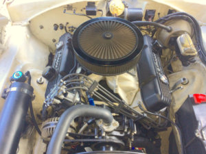

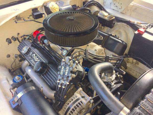

This is my 67 GTX, pump gas 493 combo
536 HP @5,200
583 TQ @4,000 on 93 octane unleaded.
1967 440 block, line honed, decked, bored 30 over with bore/hone plate, ARP main studs.
Eagle 4.15 crank
Eagle rods
Icon Dish pistons, #IC840, Step-dish -23.7, .990 pin,
final compression ratio 9.7:1
Edelbrock Performer RPM Intake
Demon 850 cfm carb
Edelbrock RPM Heads 84cc camber intake gasket matched no porting.
Comp Cams valve springs #953-16
Comp Cams 10 degree Titanium locks.keepers
Crane 1.6 Gold roller rockers.
Trend custom pushrods 8.625
Crane Hydr. Roller Cam #HR-230/352-2S-12
230/236@.50 gross lift .529 in .538 ex
Cometic head gaskets #C-5461
Cloves true double roller timing set #9-3625 TX9
Milodon Bronze gear Drive shaft #21525
Milodon oiling system #21001 single -12AN External pickup system
MV-63 HV Pump stock, pickup boss plugged
Milodon oilpan #30931
Milodon stroker windage tray#32005
ATI- Super Damper #917470E
MSD 6A BOX
MSD PRO BILLET Dissy
MSD 8.8 Wires
NGK spark plugs #R5671A-7
TTI 440-200 2" X 3-1/2" Ceramic coating
TTI 3 x pipe Full exhaust /Dynamax Super Turbo's
Vavoline 20W-50 VR-1 motor oil summer/ late fall VR-1 10W-30
727 trans
Pro Torque Converter. Had them go through stock converter that was behind the original motor and had them raise the stall another 300 rpm.
Trans-Go shift kit
Coan bolt in super sprag # COA42801
Kevlar front bands
Red clutches
4 pinion planetary's
Deeper stock A-518 oil pan
B&M Super Cooler
Rear stock 3:23 742 case posi, Mickey Thomson Drag Radials 255/60 -15
Car sees a lot of street time can drive it any where.
Drove it 200 miles round trip to the "MOPARS at Englishtown" show with intentions to just show the car but was wondering what it was running ,rented a helmet from the track and got a time runs in she ran 12.53 @109. no tuning just as I drove it there. 3/4 tank of gas, spare tire, tool box, cooler, folding chair and a classical guitar in the trunk "no kidding" lol was not watching the tach just shifted by ear.Think with some proper tuning and a gear change 3:73's there's a 11.99 in there ;-)
Been a few years since I've been down the track, felt great, and got a 2nd place trophy in my class in the car show & made it home safe. ."It was a good day"
I don't have a local track anymore so if I want to run my car I have to brave the 100 mile drive through Staten Island & New Jersey dodging the pot holes and crazy drivers.
We are trying hard to get a track back here on Long Island but the land is so dam expensive and its the not in my back yard syndrome.
Facebook "L.I. Needs A Dragstrip" where trying hard !! UPDATE !!!! Englishtown Raceway Park just officially closed its 1/4 & 1/8 mile dragstrip !!!! The end of the Summer Nationals. :-(

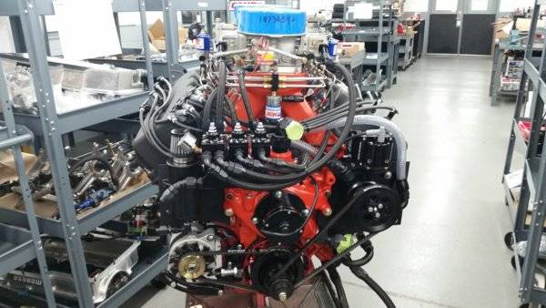

First 500" combination:
'71 230 "B" 400 block, 440 source 4.15" stroker kit, flat tops, no dish. Forgot the valve relief CCs?
Edelbrock Victor MW heads with port clean-up. T&D 1.6:1 rocker arms.
Comp 264/264 @ 0.050" HXL lobes on 112 LSA cam, PAC-1325 springs
Indy 400-2, 4150 flange intake with 1,000 cfm Holley HP carb.
2" Hooker headers connected to full TTI 3" exhaust system with the supplied super turbo mufflers.
14"x3" K&N filter with K&N filtered top.
Ultimate 9" "Tight" torque converter
All accessories, except A/C, full interior street car that dosen't hook well.
Chassis Dyno was around 550 RWHP, and over 600? ft/lbs, but not a good torque reading because of the converter flash to almost 5,000?
On the chassis dyno, peak power looked to level off and fluctuate? Also the engine did not feel smooth.
I think I ran a best 11.60 @ 120 here at Bandimere (altitude) in the #4,150 pound charger with stock suspension and 4.10 gears. Pretty bad '60 times, usually over 1.7 to 1.8?
Had valve train issues with the Victor heads.
As for street driving it was pretty good and I was impressed with how tight the converter was. It really did not flash up unless you layed into the throttle. Maybe not the best for the track, but nice on the street.
Second 500" Combination:
Working with the combination above, Had it re-balanced by a different shop. The first shop (first time I used them) said they "balanced" the assembly which should have already been balanced by 440 source, so I was curious if that shop screwed up the balance job, and they did.
The second shop corrected the first shops "balance" job which ended up being pretty close to what is was when I got it from 440 source in the first place. At the time, around Christmas a few years ago, Hughes was running a sale on the Monster CNC ported Victor MW heads, so I got a set. They flow 400 cfm, quite a bit more than the 330-335 of the old heads.
I also, changed the cam. I don't recall the exact specs, but started to worry about piston to valve clearance. I think the cam is another Comp HXL lobe design 272/278@0.050 duration, 110 LSA, around 0.726" lift.
Worrying about the stability, and because I got a deal on the springs, went with the stiffer PAC-1326 valve springs, and thicker wall (0.120") 3/8" pushrods.
I don't have any dyno numbers on this combination yet, but ran about the same times as the the first setup (mainly limited by traction), but much smoother in the higher RPM range. I then changed to E-85 and have not got a handle on tuning it yet. Because of Medical reasons and work, I only ran the car once last year and something went bad over the winter? Not sure if it was the E-85 fuel, but that is what I suspect.
I am looking to make some chassis adjustments to 318 T-bars and adjustable shocks to get some weight transfer in the car so it hooks up, but since the car has no roll-bar I really only tech to 11.50 ETs anyway.
Edit: I forgot, the Compression ratio is around 12.4:1
