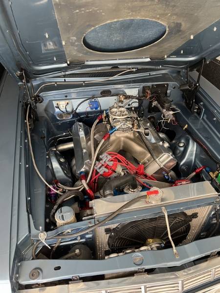

Well this is just a little ole 540" NA Mopar. No spinny things, no bottles.

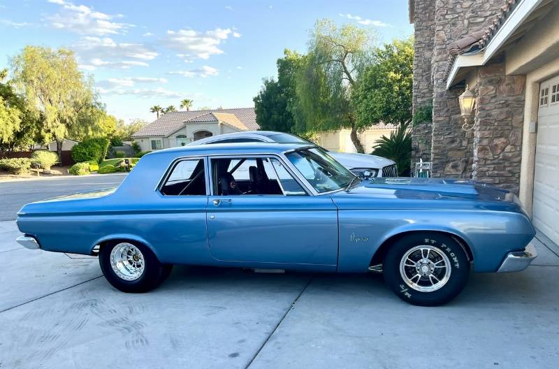

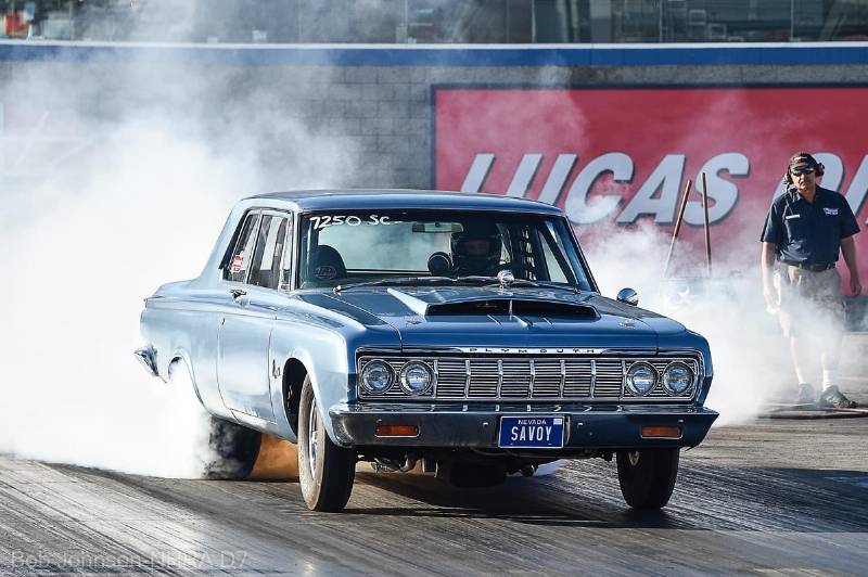

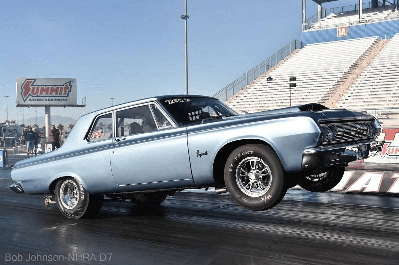

Sorry gents I don't have many pictures of the car really as I have been concentrating on making it work well. We are now getting ready to tear it apart to bring the car up to the standard of the mechanicals. But I have a few

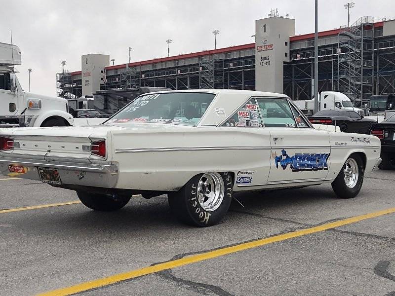

My name is Jeff, I met you in the staging lanes at a Friday test-n-tune at LVMS a few weeks ago. We talked for quite some time waiting to make a pass. I drive the white '66 Coronet (this one) Your car is very impressive. according to Wallace you are making over 1000HP with that thing . . . damn.

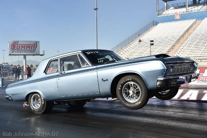

beautiful car, please share build thx

What would you like to know. Its pretty basic deal. A 540" low deck with B1 heads. the usual list of good parts 55mm cam, billet crank, GRP rods, CP pistons at 14.8-1 compression. B1 heads, T&D paired rockers, Manton pushrods, Isky lifters, non ported B1 intake and wither has a 4150 or 4500 carb. Custom non step 2 1/8" header and generic collector 4". Backed by a Joels on Joy proflite with a 2.28 first gear and ATI converter. Rear is a Dana 60. tires are 29.5x10.5 stiff side wall M/T's on a 13" Wheel. Rear is mini tubbed only. Car has ladder bars and full cage. Double adjustable Strange shocks on each end. Strange Brakes on each end. Everyhting is still in the car as delivered. All glass and all steel.
Car is currently already apart to bring the cosmetics up to the level I want and to match the mechanicals. Also will be rewiring the car and doing the interior as well. Also engine will receive some upgrades as well. A bit more compression and more modern cam profile. Maybe step up to an MC head as it would be great to go 8.50's here in Vegas. I still take it to local cruise nights so wont be anything to over the top. Works well like it is so main thing is keep it as least as good as it is now.
That does sound basic. You must have the thing set up really well.
We work very hard to get the most out of a combination. This one still has room to go if I make no changes to the engine. Front shocks to eliminate bounce on landing and converter is WAY to tight. Also have another gearset for trans I may try with a 2.38 first. As well as some more tweaking on the carb.
