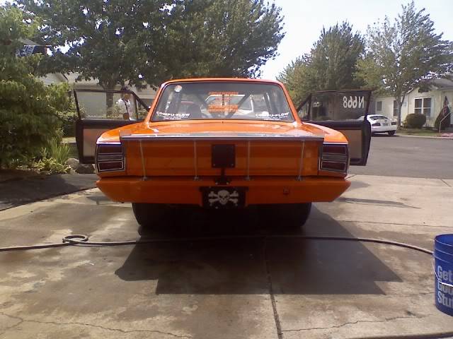

well dyno was good so went to track. friday night. that not so good. 1st pass 6.80 in 1/8 not in it all the way.
2nd pass tire spin and bad launch
3rd pass, good launch then at 100ft car left turn into wall
any input why car would suddently take hard left, always been straight before.
tires 7 psi good straight burnout, only concern was track prep. could that have been cause.

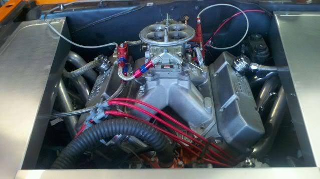

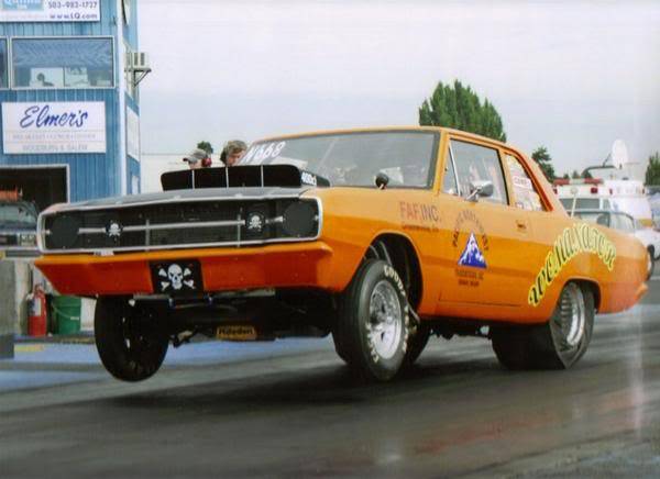

1968 Dodge Charger with 526 Indy headed, 1050 Pro systems carb, Msd Pro Billet, Indy intake, Jesel roller lifters, Harland Sharp 1.6s, Billet Fabrication 12 qt oil pan, 8" Coan converter, 727, Dana with 4.10 spool.
Ran 9.84 @ 136.5 with Hoosier 275/60 Drag radials. Picture has slicks and went 9.95
