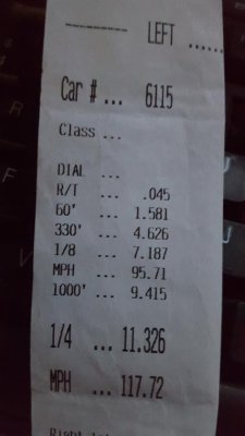

Here is my best. No ss springs though. I have the xhd springs with 275/60/15 radials. No bar, stock stroke .030 over 440. MPH best was 118.26 this spring. Car weighs 3690 with me in it.My best 60 ft. was 1.567

That is really good 60ft times man for just some XHD springs though and especially with that heavy road runner she looks good! Thats why I love my mopars they are always impressing people.

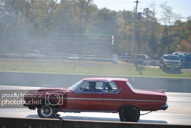

My 63 is a street car I race sometimes. I use basically all stock suspension with 3400 lb SS springs in the back with the longer MP shocks. Up front is all stock suspension with just Comp 90/10 shocks. Thats it for the suspension as the rest I rebuilt with stock parts. I race it in full street trim through the full exh on 92 pump as its a 440/493 I built with good quench and 10.6 comp using aluminum heads. Runs good on 92 pump as I have never had race gas in the tank and I have never uncapped the car. At just over 3700 lbs best et is 10.76 @ 124.79 with a 1.50 best 60 using my Dynamic 9.5 conveter that drives great on the street and will flash about 4200 at the track. I usually drive it to the track unless I race to far from home to chance breaking and not having a way home. I drive the car all the time on the street and have only raced it once a year the last few years. Ron

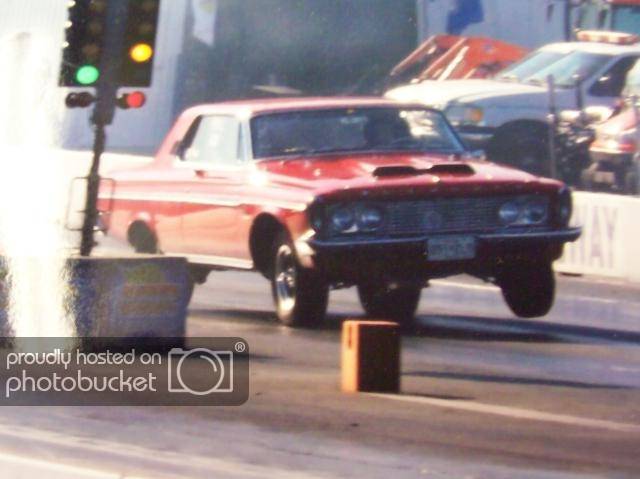

A launch pic where I redlighted against my brother's 64 in a time shot. Ron

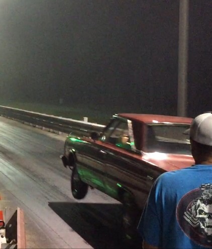

When you say twist, you mean like this??
Nice launch there Bobtile ! Ron
Car has a bad twist in it and it wants to drive to the right as soon as I launch. I have a 14 pt roll cage
I usually stack my own springs. Have you tried going with a heavier spring on the right? You can even take out a leaf or two from the left to see if it changes the roll. A simpler way to experiment is to stick on an air shock on the right side only and play with the PSI and see if that will help reduce the body roll. If it does, then you can make adjustments to the springs or install a better shock mount and just keep the air shock. Is your battery mounted to the right rear of the car? Move it to the left. Add a sway bar to the rear. Lots of things you can do to change the characteristics of the car but can only imagine what the leaf springs are going through with that much roll going on....and they do break when pushed beyond their limits. Buddy and I went 11 teens with a 4 speed road runner and decided to throw on some ladder bars and not mess with all the movement and driving left or right. When the rear end is allowed to move a lot with leafs, they can actually steer the rear. If one spring is staying pretty flat and the other is arcing, it'll steer it.....
That is very impressive 383man especially since you drive it on the street all the time and having such low compression I can only imagine the heads that turn when you roll by LOL

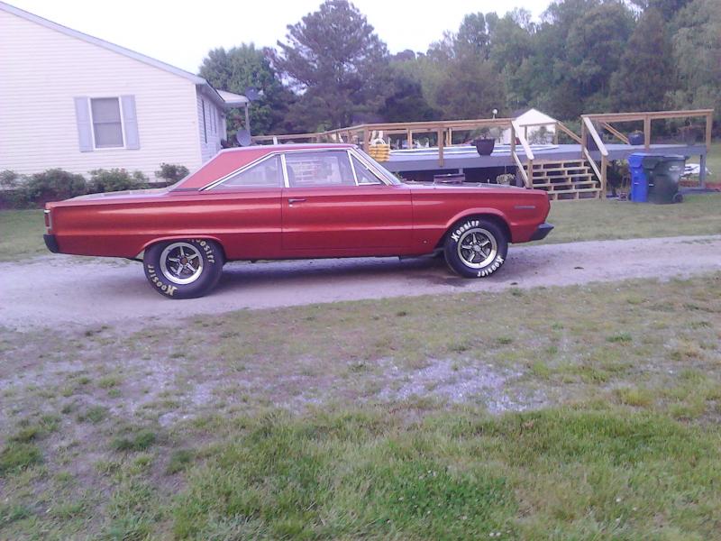

Got a picture of her though finally :)
Needs a hood scoop I know lol

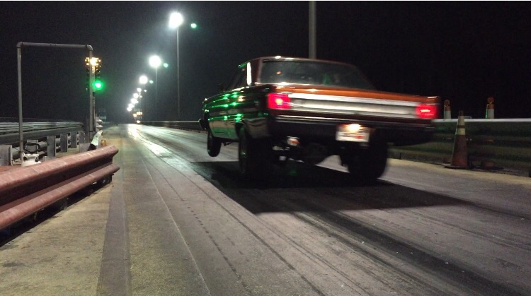

I got some crappy pics
Nice pics SAM67. Whats she run and whats the combo ? Ron
