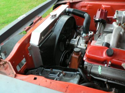

A 26" Radiator will fit absolutly perfect-
Id go the route of chaging to a v groove march pulley system that allows for mechanical fan and radiator with shroud
