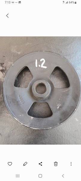

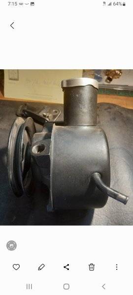

I bought a power steering pump a few years # 2129623 and my power steering box is # 2267282 in my 69 Charger will they work together.It is a TRW pump.
Pump does not care what gear box you have.
Bigger issue is correct mount braket for your engine type and correct pulley. Don't think the 69 Charge would have used a TRW, and TRW came in small and large size. Small for B body. Sure it is not a Federal pump, they look similiar.

I would have thought TRW small pump for B bodies, but it parts calls that out. You can always switch to another pump, but bracket, pulley (offset), and hose will/may need to be changed. TRW small, Federal, Saginaw, should all be able to be made to work. Correct pulley is usually the rub.
