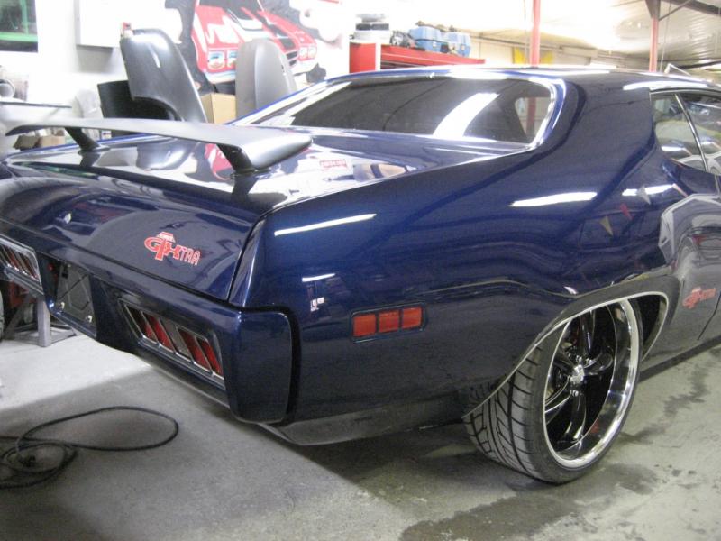

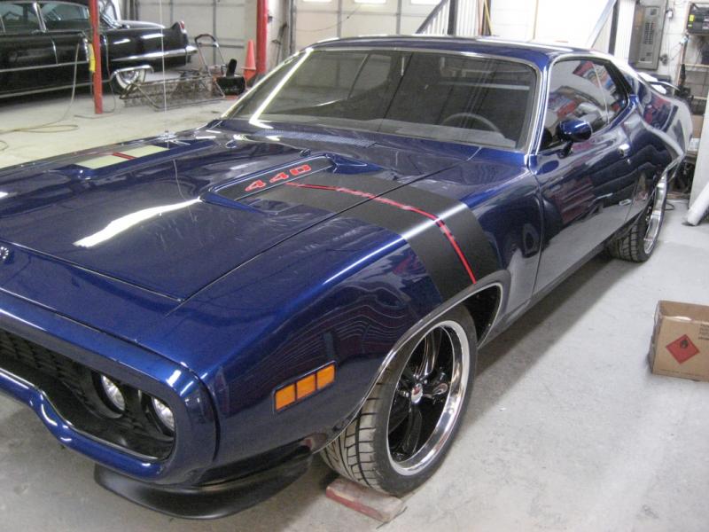

BEAUTIFUL car Bro! Sorry to hear of your problem, sounds like the adjustment idea should be the fix. I have not seen this but I spoke with a guy who told a similar story and his fix was the adjustment.
