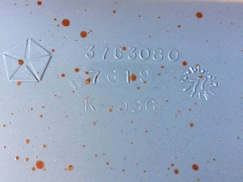

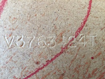

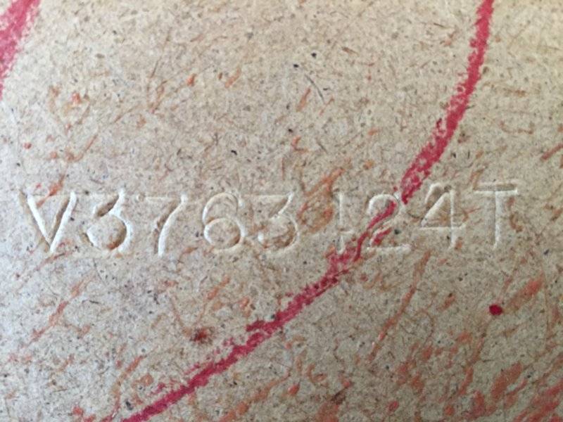

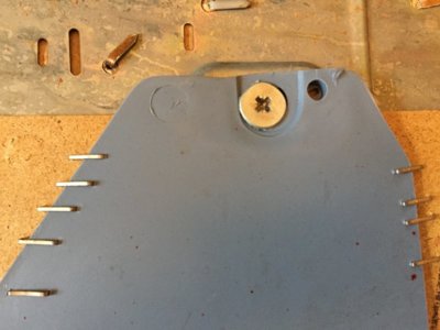

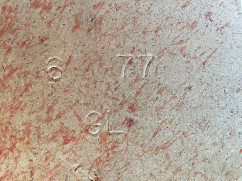

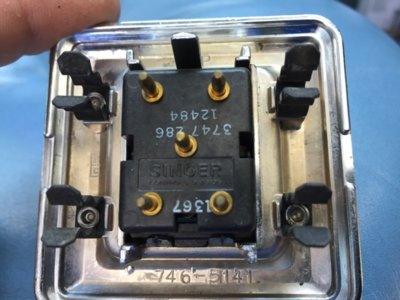

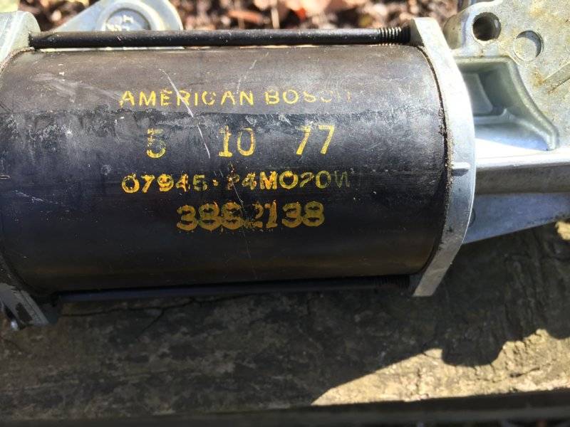

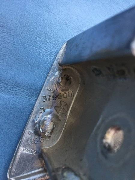

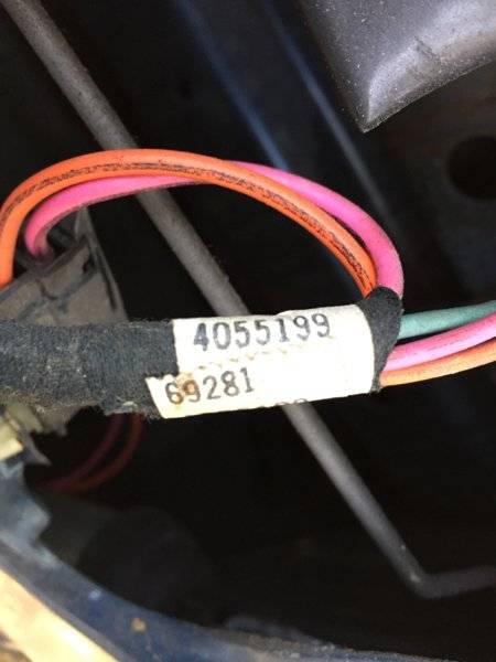

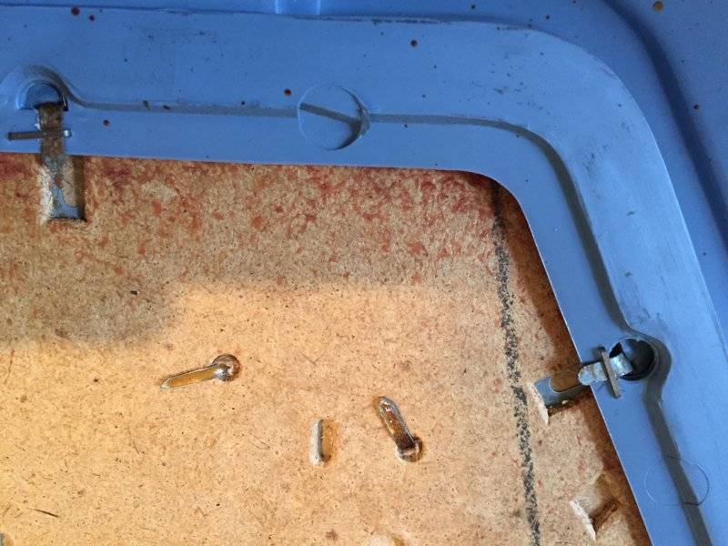

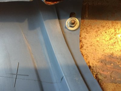

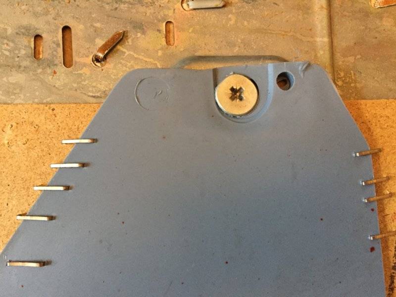

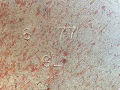

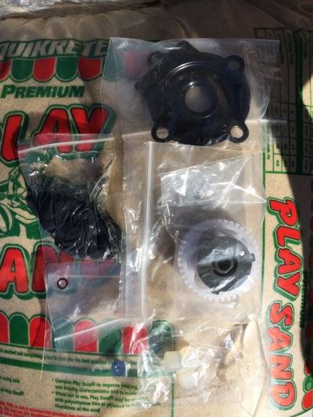

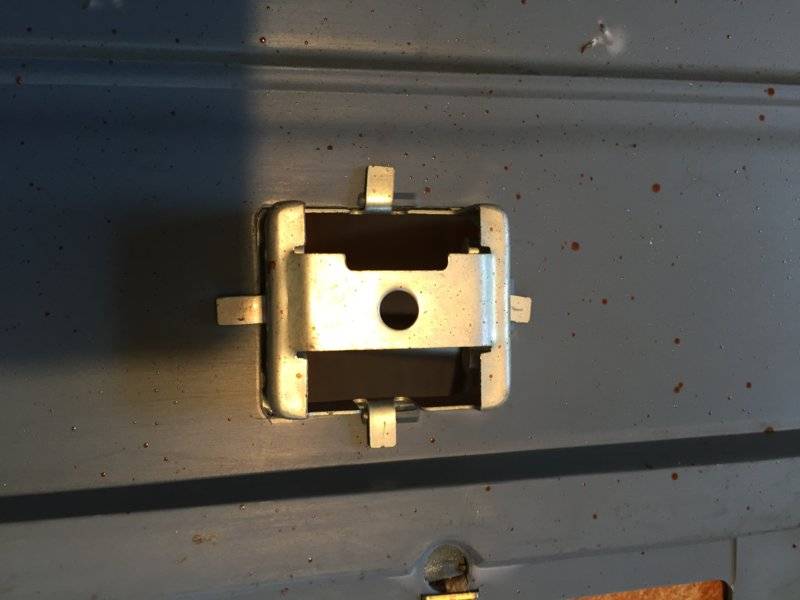

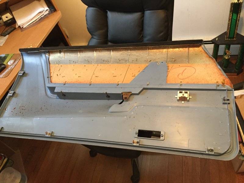

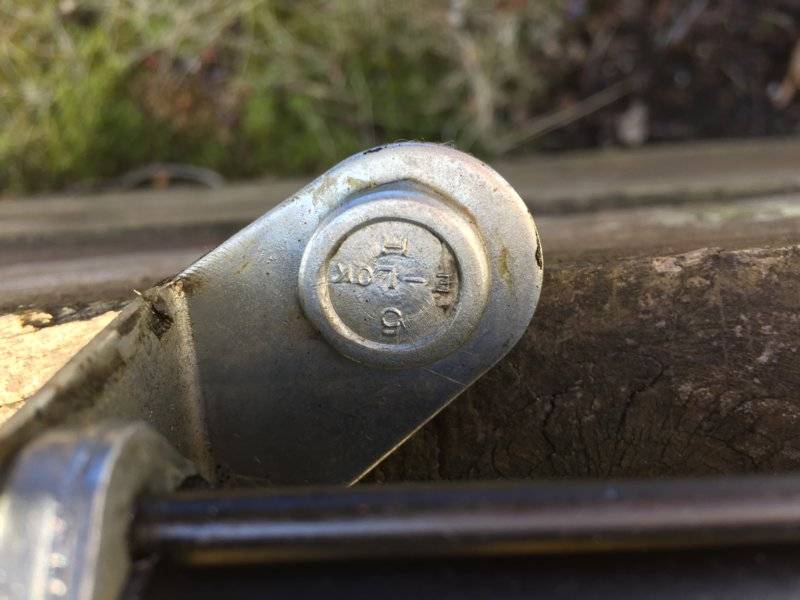

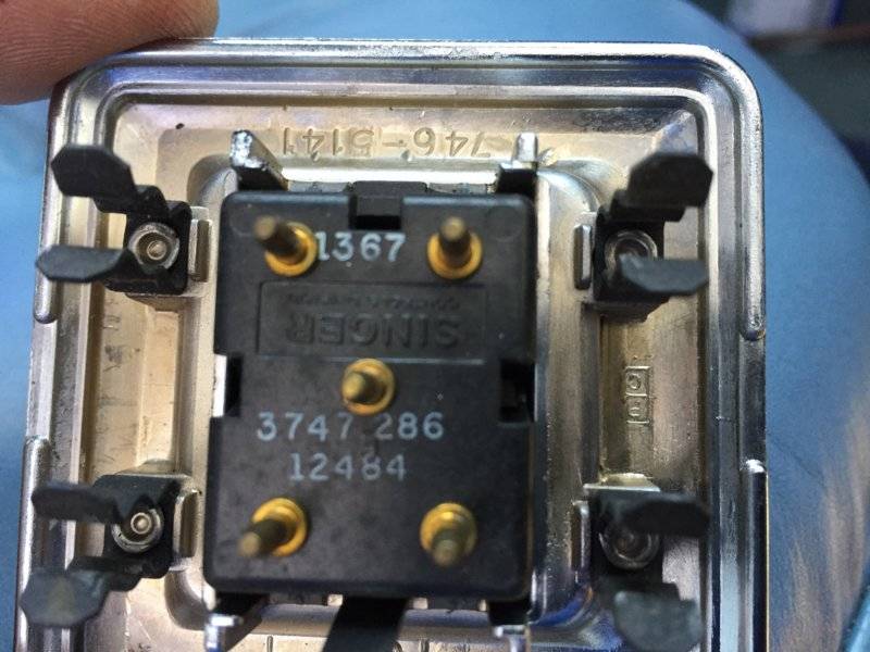

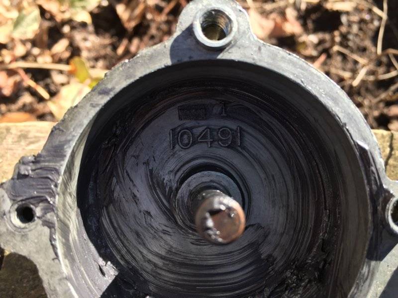

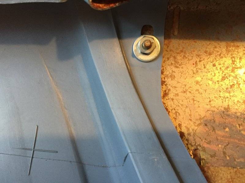

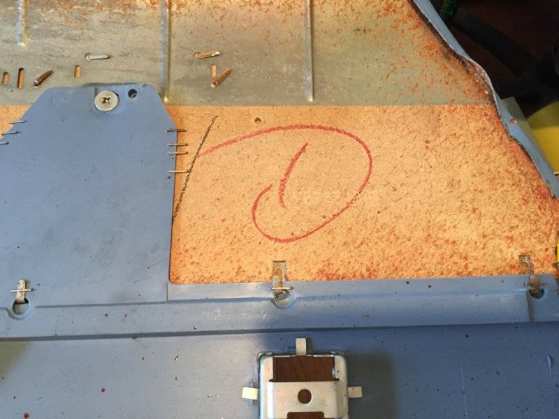

Went to the last show of the year back in November at Atco dragway. Passenger side window decided not to work properly. Anyway,purchased a new gear kit and repaired it. Took some pics of part numbers and such as I hope to never need to go back in there. Trying to do this anytime I take the car apart. Pics if anyone cares.

thanks for pictures have to take apart my 66 looks alot like mine .
dose anyone know how long the motors are the same .because that looks the same before i get mine out.
yep.
There is one different mounting hole that is used some years and not in others, that is either not there or there and not used depending on the year of the motor, and IIRC late B cars had them swapped left to right vs early cars and F/M/J
yep.
I think in the 80s they still had the pre-mopar DPCD logo!
Nice photo documentation John!
Kinda surprised they still make those gear kits. First time I replaced one I made the mistake of not securing the regulator arm before unbolting the motor. Luckily all my fingers came out of the door still attached.
