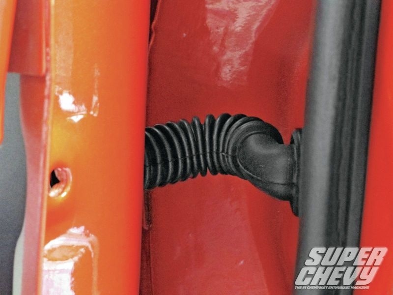

I replaced my manual regulators with electric ones from A1 Electric. I bought their wires, relays and switches. I think Mark B is right about putting the hole through the dimple.
I used new style rubber wire looms like these to protect the wires and seal the holes.

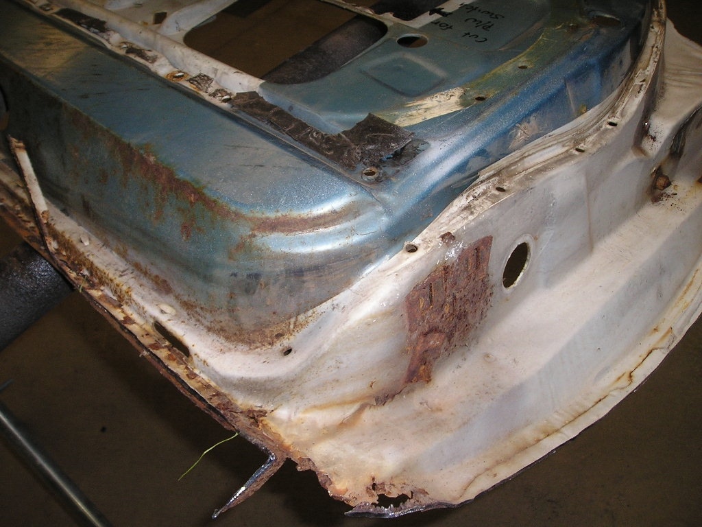

Here is a '68 power window door. Note big *** hole above hinge location.
