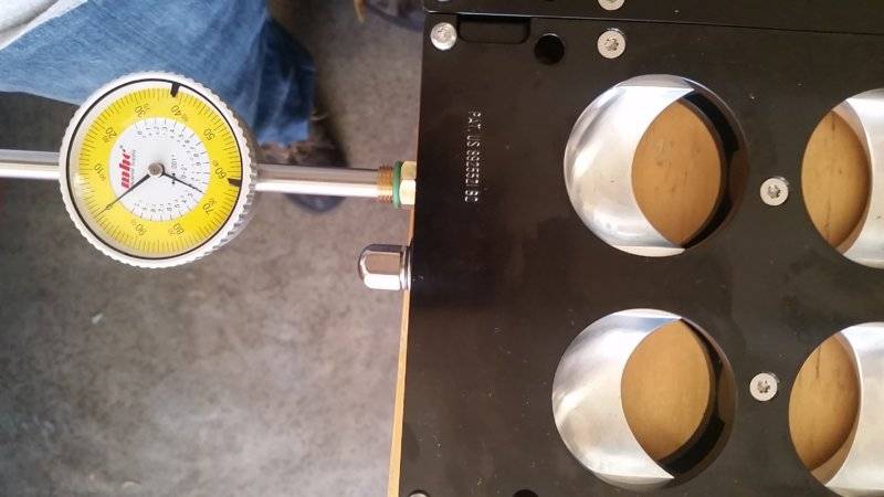

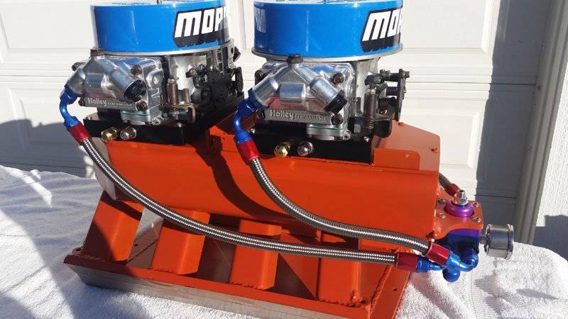

Shown below is a picture of the restrictor plates mounted under the carbs and a picture of one of the plates closed down 50% as they are set up now under the 2 Dominators.
