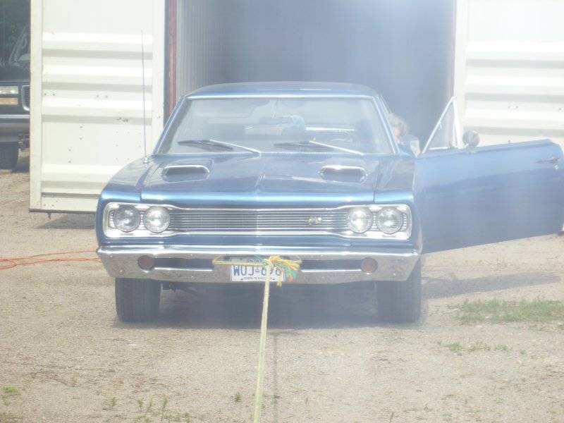

383 in my Bee was rebuilt in 1976 for 300 bucks!. I use to store it each time I put it away, with it running, by dumping 1/2 a quart of transmission fluid down the carb 'till she smoked like a bitch and then smother it. As years went on I got lazier and lazier and just parked it. Before I restored the car it had been in a marine container for 14 years. Wife and I dragged it out with the tractor the Fall of 2014, I broke the hardened fuel line off of the pump and hooked up my 9.9 merc kicker can. Cranked it twice and it was running as smooth as the day I put it away. Still running... 48 years post rebuild. I did do the valve seals and timing chain during restoration, nothing else!

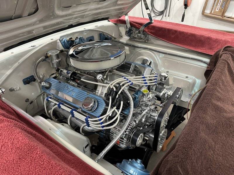

Again, thanks for all the input. While a PITA I'll pre-lube which is what I was thinking anyway. Not as simple as stated above because of all the detail work I have done but no big deal. Can't just "shuck the distributor out of there". See below. Pulling the distributor is a little more involved than the typical driver or race car.

Wow, nice job! The ignition wires and looms are awesome. Did you polish or have the MT covers chromed?

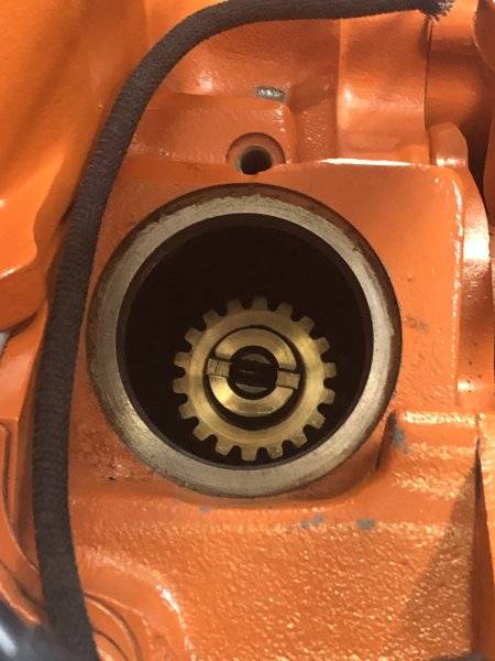

To try to minimize screw ups, I set mine at TDC, mark the housing and block, and take a photo of the oil pump drive position.
If that is at TDC, distributor drive needs to be turned 1 tooth CCW to get drive slot exactly fore/aft. All this will affect, is where the vacuum advance pot will sit when the ignition timing is set.
Your looking at dist base with hold down clamp. Remove clamp make sure dist won't move. Clean dist base and block so tape stick. cut a piece of tape 1/4" wide 1" long. See picture, put tape on dist base to block where hash marks are. Where I put a bunch of red lines cut tape so that tape stays on dist and block when you remove dist from block. You need to know where dist rotor is pointing. After removing dist take picture of oil pump slot location so when you put it is in same spot. I take picture from passengers side of car/engine. Just put everything back the way it was. Turn the engine over your going start from scratch.
