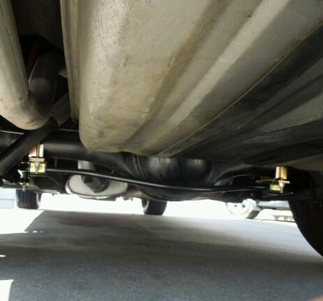

I had my suspension shop install the 3/4" rear sway bar from Firm Feel. Theirs is the frame hung one that sits above the axle instead of below. As I watched the shop guys do the install they had quite a bit of trouble snaking that rear bar through the rear suspension, 8-3/4 housing, exhaust, etc., and at first they said they weren't going to be able to do it without some major disassembly. But then the owner came over - great guy I've worked with a few times before. He personally got under there and had it figured out in less than 10 minutes. They got it all installed after that in about an hour. I'm glad I had them do it, because I thought it was quite simple, but I'm sure I would have been cussing under the car if I would have attempted to do this the first time myself.
End result: FANTASTIC! I love how it mounts up nice and neat under there. The car is in the body shop now and I forgot to take photos, otherwise I would have done so, but the Firm Feel website has some really good photos that show how it looks.
After driving the car under normal non-aggressive driving conditions I have to say that I'm glad Cranky steered me towards getting the rear sway bar. It really made a big difference in the steering and I'm sure at higher cornering speeds I will also feel it.
If you're going to add a large front sway bar don't stop there - add the rear bar too!

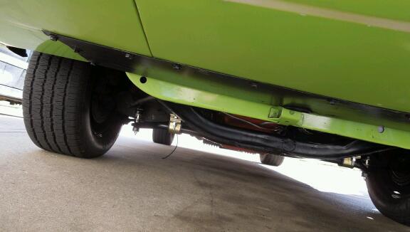

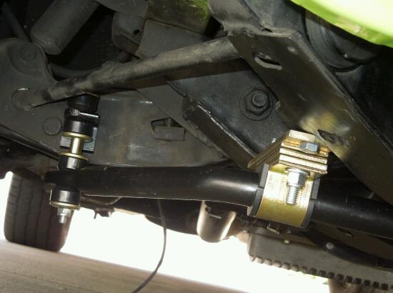

Just did this also I got front and rear sway bars , 1 inch torsion bars and a steer & gear firm feel box . The car drives like a brand new car . Love it
