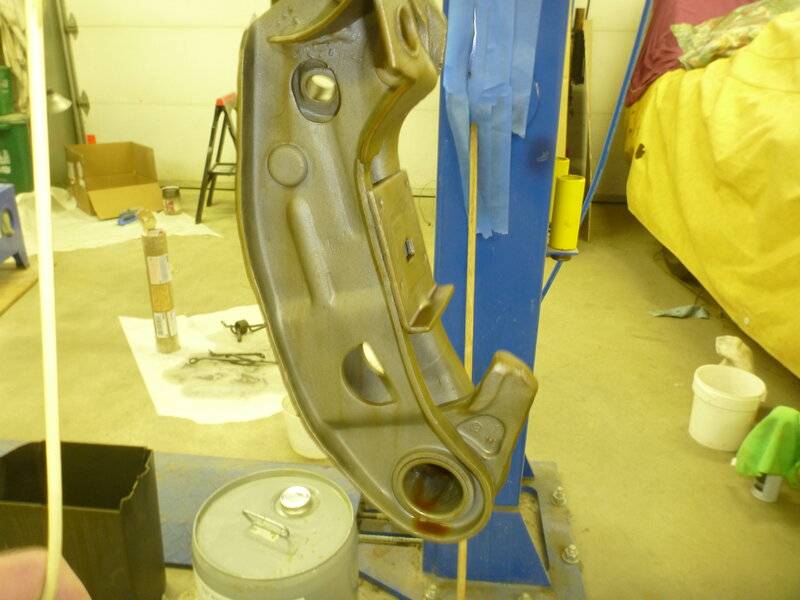

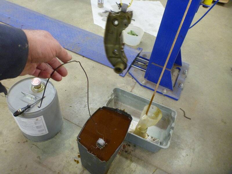

I would love to see some refinished LCA’s and know what you used to finish them with. Highly unlikely I will do cosmoline, so curious what else looks good.
But cosmo looks so nice, now for how long who knows.
Driver ? Trailer queen ? Durability ? 100 point car ? What are you looking for ? Cosmoline, paints, powder coating, ECS's - RPM ....

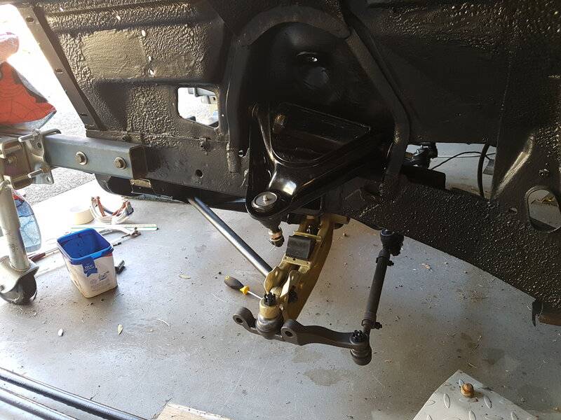

I am looking to paint them. Not a show car. Nice weather driver.
Is that the name on the can? The color?
I just googled it. Is the color "Bronze"?
Ok that is a Aussie thing eh?
Yeah that's the stuff. About $40 for a liter, sprayed it myself. Not sure if they sell it in the US though.

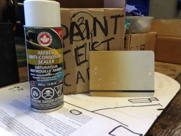

I've asked this before a few times. I just want to spray paint them. I'm colored blind and would just pick out the proper tone/color if I could tell. I've asked the young fella to come to the hardware store/Canadian Tire to pick out the right color. We never got around to it yet. There has been a few products that is being used but don't ship to Canada. I tried this stuff on a test card but does not dry and is the wrong color. It's still real soft and it's been over a year. I just took that pic and still soft.
Yes I know how can I tell the difference you might ask? Well color blind people can tell the difference in shade and hues so to speak. I did a few tests on line. To determine this??? Plus different degrees of color blindness.

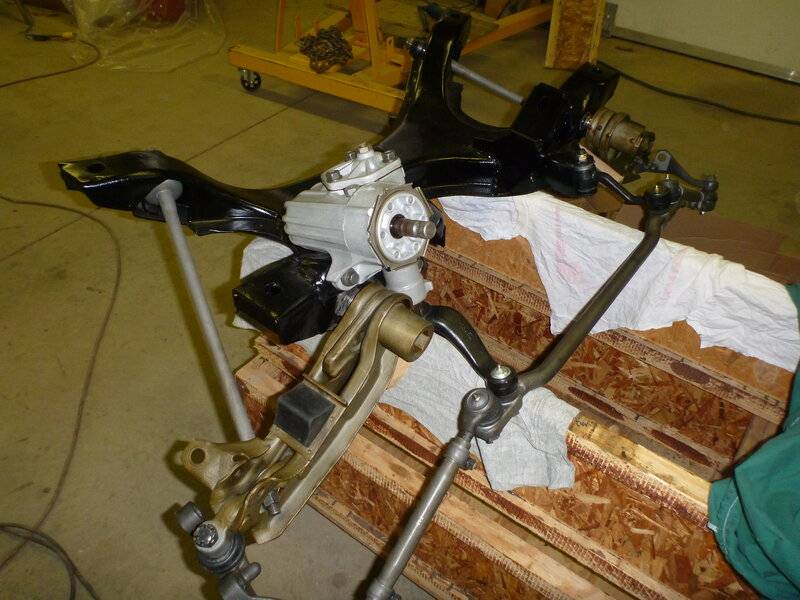

I used Resto Rick’s “Quasimoline” on mine.
It’s been on for a few years, and is holding up great!
