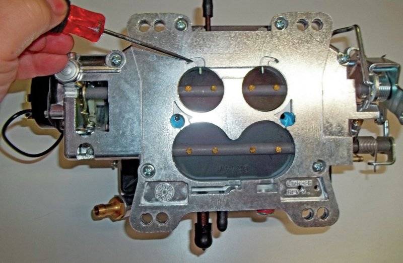

Something I forgot to mention is that I bought a Street Demon 625 with the composite bowl for my wife's car...it sometimes sits a month but usually lights off almost instantly.
I know a lot of people think those are junk but it has been the most problem free carb I have ever had. It was spot on out of the box...and it didn't cost $500+

I've had nothing but great things to say about it. I was actually looking at smaller carbs for hers as it's just a 302 and only mods are ignition and headers so I was a little worried about over carbing w/625. But with its smaller primary opening its great for idle and low rpm response. The larger secondary ( I think they call it a goggle valve) is more than adequate when laying into it.
I think they make an 750 version too. Some people call it a reworked T-quad...I like it.
It's simple,
I've always liked Holleys but with today's gas even with the high dollar bowl gaskets, they seem to dry out and leak after a year or so..dont have to worry about that with the Street Demon...Eddys are a pita for me...
