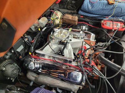

Had a friend ask me about my F.I. system and if I thought it would work on his car.. I wanted to try another install, so he brought the car to my house for electrical fixes, Edelbrock Pro Flo 4 and Dakota Digital dash install

Yeah, waiting for the Tank.. the only real wiring update you need to do for this system is an ign feed for run and crank.. Car has a 1 wire alternator and adding Dakota Digital makes life easier..
Fixing wiring and doing the install, need to fix the plug wires.
Thought I better update this.. Got the car all back together and running.. She runs so good, she needs brake up grades now..
