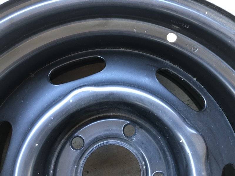

Mine came out great. I used a 15+ year old Eastwood gun. They’ve been collecting dust so I gave them a quick wipe for pics.
I glass beaded them, sprayed generously with brake cleaner, then used 100 PSI through an air nozzle to dry them.
