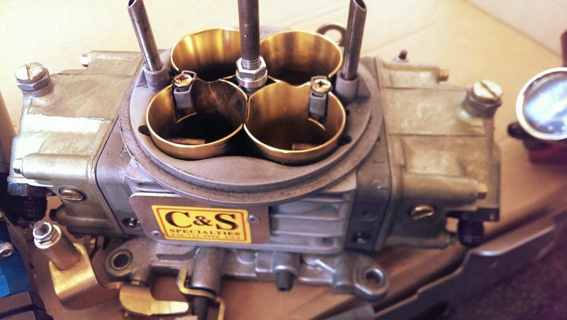

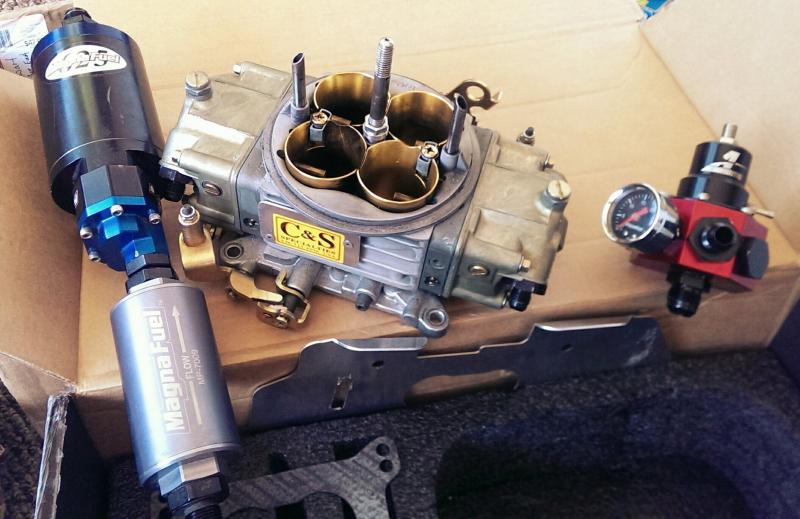

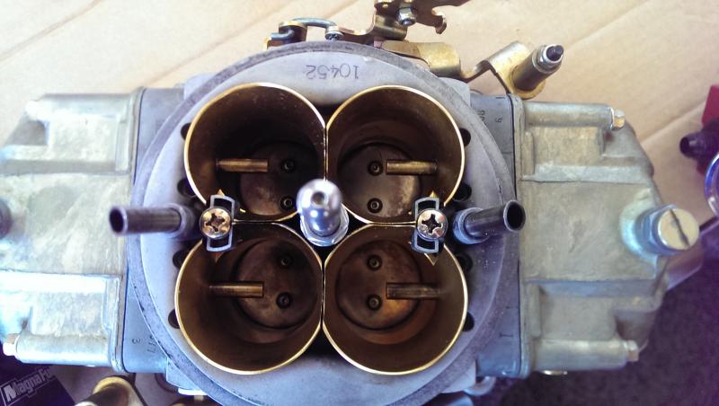

What you're proposing is exactly what I'm doing. I have a D1X that will be running through a C&S 933 CFM Blowthru aerosol (awesome for drivability I've been told) on my Stroked 440. (522 crate) and plan to run around that 8-10 psi (BUT NEED TO LOOK AT THE WHOLE PACKAGE AND WHAT I WANT TO ACCOMPLISH AS ADVISED BY HEMIRUNNER)
