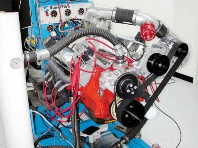

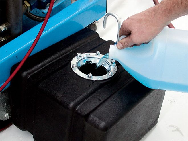

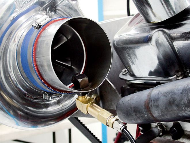

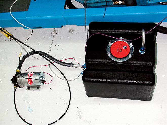

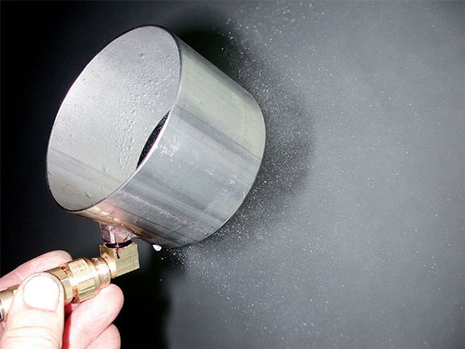

Stealing some pics and explanations from the HOTROD article in regards to the water meth installation:
To aid in running high boost and power output on pump premium gas, the optional water/methanol injection system from The Supercharger Store was mounted to the inlet side of the compressor. The comprehensive system comes with a pressure switch, anti-siphon valve, a pump, tank, and all of the required hoses and fittings.
When activated by a boost-referenced switch, the water-injection nozzle sprays a fine mist of cooling water directly into the compressor inlet. The effect is charge cooling. A cooler charge makes more power and reduces the tendency to detonate, while detonation suppression is further augmented by the introduction of water to the combustion process.
The water-injection kit is complete with a fuel cell to hold the fluid, a high-pressure pump, the pressure switch, a check valve, and all of the tubing is supplied with quick-disconnect fittings. Its all there, and we had it quickly rigged for dyno duty.
Various blends of water and methanol can be substituted for straight water. An easy way to get an appropriate blend of methanol/water is to use windshield washer fluid, as recommended by The Supercharger Store. Formulations vary in percentages and for winter/summer grades. Check the product data sheet or label for the contents, or get a recommendation on brands from The Supercharger Store.
Read more: http://www.hotrod.com/how-to/engine/mopp-0604-440-mopar-engine-build/#ixzz3Y9VQQkom
Follow us: @HotRodMagazine on Twitter | HotRodMag on Facebook

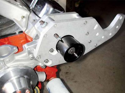

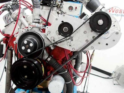

Also here are those pictures I was talking about goon, see how they just have that single idler/tensioner pulley set up? I was planning on something like that, but that's why I asked if there's any added benefit to that sprung swing-arm style one you're talking about using and is on Joes setup ?

Hey goon I'm having a hell of a time finding any info on the swing arm vs static pulley topic, but the best I can figure I would thing the static pulley would be less prone to slippage if anything. I'm just considering which would be easier to make lol Joe, any insight on this?
And dreadlock, yeah I'm planning on piggybacking it off the crank by machining my own spacer to put the blower pulley out in front of the stock crank pulley (in theory lol). I currently have a mechanical fan as well but I'll definitely be looking to go electric in the interest of space.

The static is strong.We had to crank the $hit out of my swing style tensioner to keep it from slipping. But if you drill and tap into your bracket and put a idler pulley close to the supercharger pulley and get the belt to wrap 3/4 around the you can use a tensioner off of any modern vehicle and it will work without slipping.My belt only wraps a little over half way around.

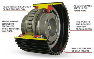

  • ATI Performance Products supercharger Super-Pulley ALLOWS for Free wheeling whe throtle is close.jpg
