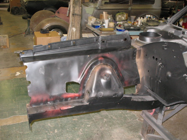

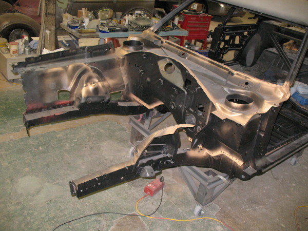

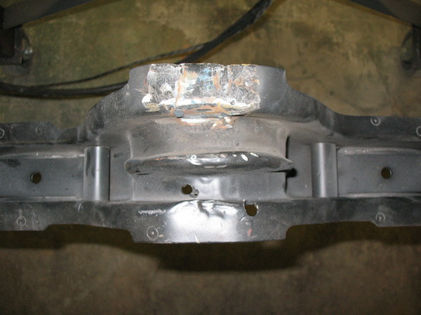

I finally got a panel welded back on the "DOG" yesterday. The passenger inner fender. It was riddled with a bunch of holes that weren't supposed to be there, so after more or less guessing which ones belonged and which ones did not, I began filling them. I did find a few pics for reference which was helpful.:grin: So here are the pics from the firewall and torsion bar crossmember repair as well as the inner fender installed. Also one pic of my steering column, before.

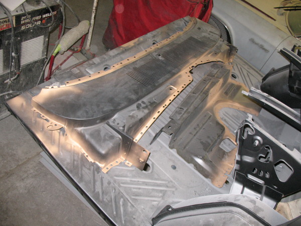

It is a great feeling to be putting parts back on!. Yesterday I prepped the upper cowl and the drivers inner fender and began to prep the interior floorpans for installation.

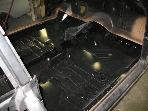

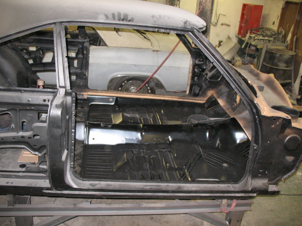

Here are some pics of parts that are prepped and ready for install as well as the dry fit of the int. floor pan. Marked the underside of the pan so that I can prep it for install.:grin: Sure is good to see something other than cement when I look inside!.

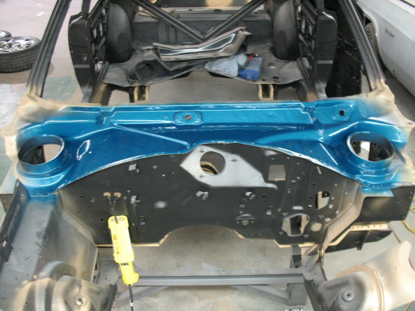

Hey guys, To start, yes body color in the cowl, hopefully it will be painted tomorrow or the next day.:grin:

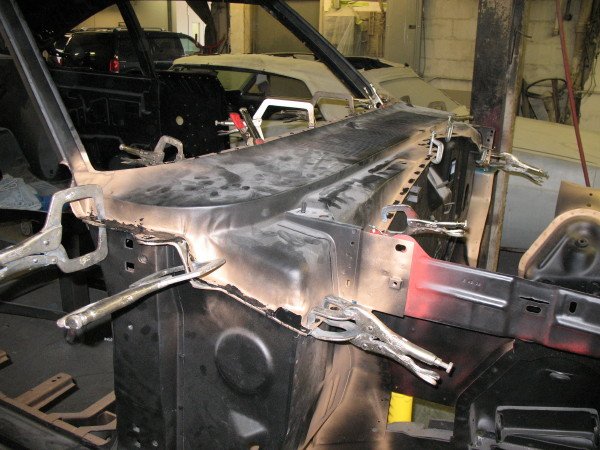

I would weld it on, that is my plan anyway, the cowl, that is. Although if it were epoxied on it would provide for a nice seel for that plenum, may cut down on some potential wind noise that you might get there. Something to think about.
The weld through primer soaks up and localizes some of the heat and it is really the only protection you can have in a welded seem, as far as I know.

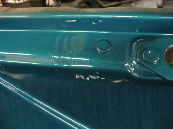

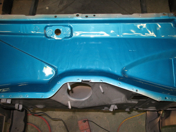

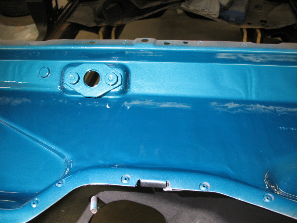

My lower cowl got painted yesterday and I love the color even more than I did before!:grin:. Here are some pics with a few different light sources. After admireing it for a little while I decided I should probably get back to work on it. I used the panel bonding adhesive on it as I had talked about a couple of posts ago. It is really great stuff to use for this particular part as it will act as a great seal for the plenum. After applying the epoxy, the upper cowl goes on and gets clamped in place for 24 hours. Will get some more done on it tomorrow morning.
