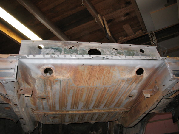

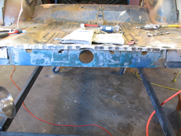

Still grinding and welding, finished welding in the package tray and fixed the crossmember at the rear just behind the bumper. The one that was on the doner parts was bent up from being dragged without any suspension so I cut out the damaged area and salvaged that piece that was originally from my car. One of the few parts that are original to the car anymore!!:rolling::rolling:

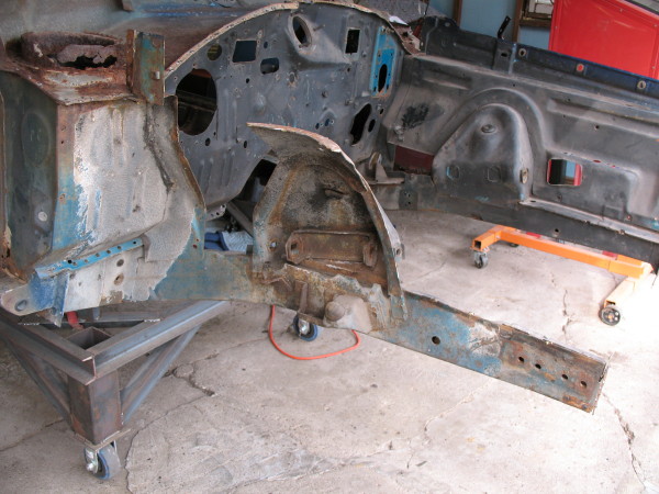

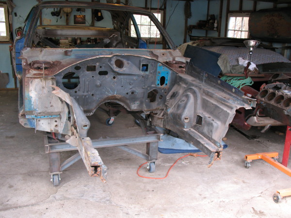

I also started to look closer at the front of the car and decided that I needed to take care of a few things up there befor media blasting. Scored a nice radiator core support online, the original one was also pretty bent and had a bunch of extra holes in it, so I decided to replace it. In the process I discovered that the passenger inner fender had been removed at some point long ago along with the core support and when they were put back on it was done with a brazing rod and a torch.:confused: I have been working on it a lot lately and am taking care of a lot of loose ends, feels good!:grin:

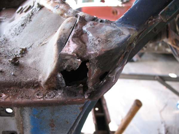

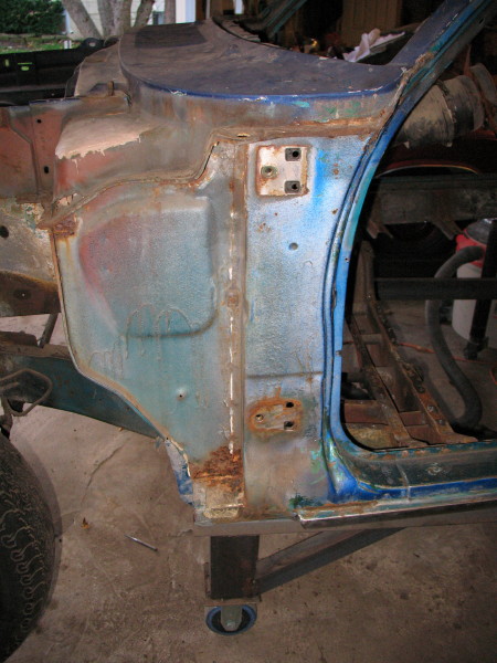

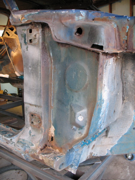

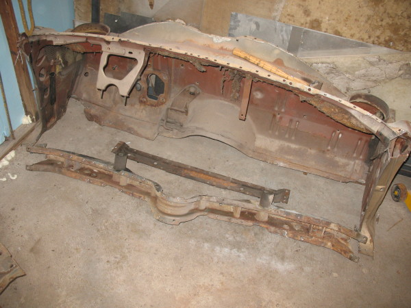

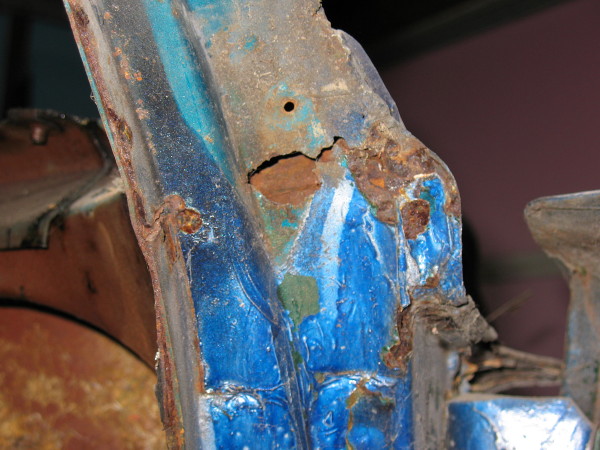

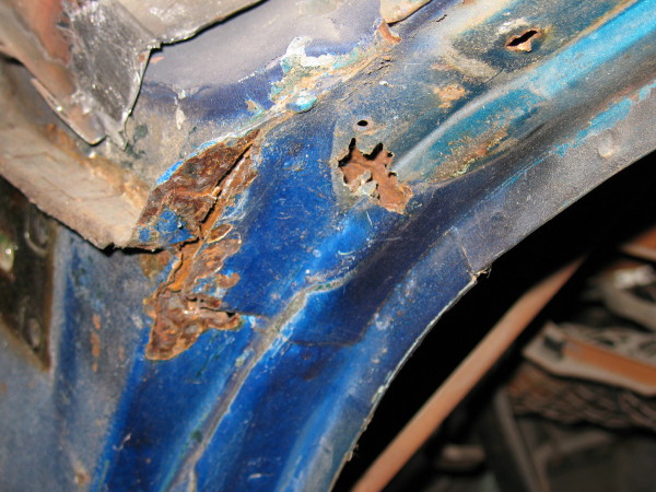

Well, I've decided, I was going to wait till after media blasting and some reassembly to do this, but after much thought I have changed my mind. I am going to replace my whole cowl section before media blasting, I think I will be better off doing it now. I will walk you through it, it should be fun, and then I can really concentrate on the outer sheet metal and hopefully have it ready for the body shop this fall. All the pics + the fact that I have decided no a.c. and don't want those holes in the firewall are the reasons I am changing the whole thing. The last pic is the candidate for the replacement, although I may have another one to chose from. The base of my a-pillars are rotten along with the base of the door jambs where they meet the rockers, the lower cowl is shot and the firewall is all hacked up, so out it comes. First step will be to brace the hell out of the car so that everything stays put while I cut this car up even further. More to come.:grin:
