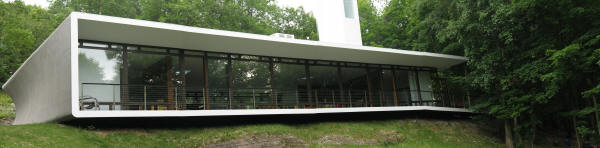

Hey General, my buddies place is in Milan, which is by Rhinebeck, Red Hook. I helped the guys that were hired to build his place and did all of the finish work including the kitchen and a ton of work on the exterior, the house has been in a few books and continues to be published in Design and architecture mags. It may be my favorite house, I love to spend time there.

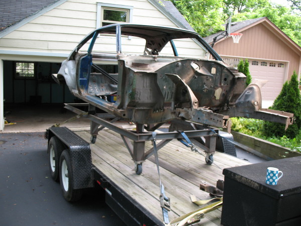

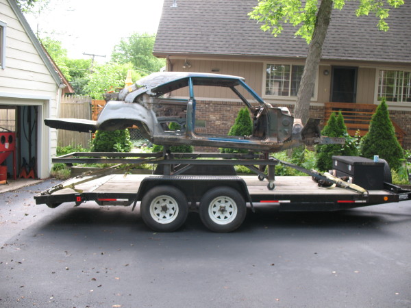

The "DOG" left left for the media blaster today:grin::grin::grin::grin::grin::grin:!!!. A huge turning point in the resto and I couldn't be happier about it!. Besides the chassis/skeleton, I also took the inner fenders, core support, fenders, door shells, upper cowl, dash frame and the k-frame. + a few small pieces. Just out of curiosity, what would you have charged one of your clients?, Donny.

...Besides the chassis/skeleton, I also took the inner fenders, core support, fenders, door shells, upper cowl, dash frame and the k-frame. + a few small pieces. Just out of curiosity, what would you have charged one of your clients?, Donny.
Hey Matt, looking good! I'd charge for what I see, and the said parts as follows, but, this is my wholesale price I'd give you, same price I give my best clients:
Inner Fenders: both of them $90.00
Core Support: $40.00
Fenders: both of them $138.00
Doors, both of them: $138.00
Upper Cowel: $45.00
Dash Frame: $45.00
K Member: $45.00
Car Shell: This one I'd charge by the hour, ($130.00) (reg rate $150.00) not sure how long it would take, I'd guesstimate about 3+ hrs of blasting time on the shell, or, what's left of the shell! :)
Add about 20% for a walk in customer.
I'm using Plastic with a dash of Alum Oxide to cut the rust, at about 35 psi at the pot, 18 or so out the nozzle. These are my cards, on the table, hope this helps in your 'negotiating' a price.
I'm interested in knowing what you are going to pay...if you chose, send me a PM.
Just so evrybody knows, Donny's price was very competitive, and I would have chose him if he didn't live so damn far away!.
Well thank you sir! It would have been worth a road trip, jeesh, if you can go down the the West Indies at will...:)
I wish I were closer to Donny, I just paid $210.00 to have 2 fenders done with original paint and no rust. Anyway, about the car,I'm very impressed and looking forward to future progress. Keep up the great work.
post pics of the fenders that you paid $210.00 to get done. I think it's a bit high; prolly the blaster is using a weak compressor; takes too much time, and he's billing by time.
There are 2 shops around here that media blast and they both quoted me the same price.(Diplomat fenders)They did a nice job, but if they were more reasonable I would have them do a lot more work.
