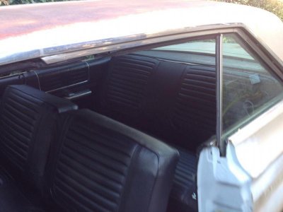

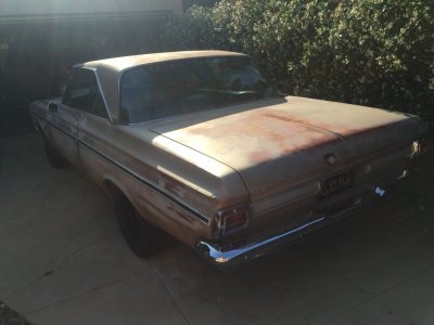

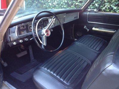

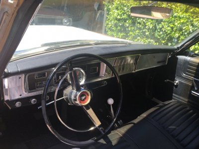

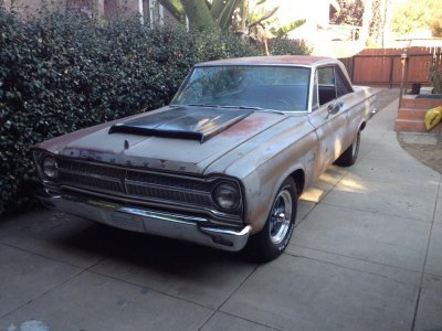

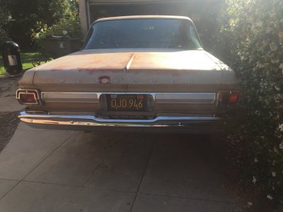

Been doing some more stuff to the 65. I installed the seat covers and carpet last weekend. Got the new tail light lenses put in. This weekend I will install the new turn signal switch so hopefully I will have functioning electrical this weekend. Also got my stickers from the dmv for the black plates soooooooo, hopefully this weekend I'll be doing legal burn outs!!!:icon_cheers:

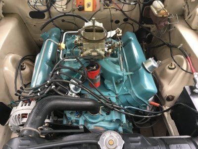

Just the Mopar turquoise paint in a can. It's a great motor. 100,000 mile 440 out of an Imperial that idles like a sewing machine, makes no weird noise, doesn't smoke and fries the tires off!
So, I just got off the phone with my friend Rich who wanted to see my 65 now. Sorry for resurrecting this old thread, but here are some updates.
Shortly after I left off with this thread, I started catching the drag racing bug again. With a limited budget I decided to upgrade the belvedere as I drove it. I tied the frame, bumped the low compression up with a set of 915, closed chamber heads(thanks Rich!), added full Tti exhaust, street dominator with a Holley 750 dp and a comp 270 magnum cam. Once I got some drag radials on it I broke the yoke on the 8 3/4 so it now has a 3.54 geared Dana 60. With some tuning, I got the car to go 8.36 @ 84mph in the 1/8 mile. I was pretty pleased as the bottom end was never apart and had low compression, dished Pistons. 130,000 original miles on short block.
