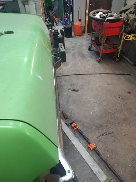

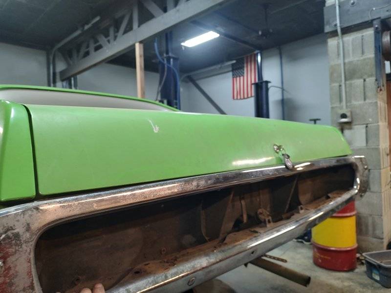

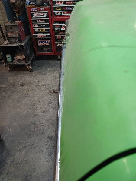

Rear bumper after a lot of tweaking is starting to match the trunk lid, the center needed pulled in and down, I should be trimming the ends to fit today.

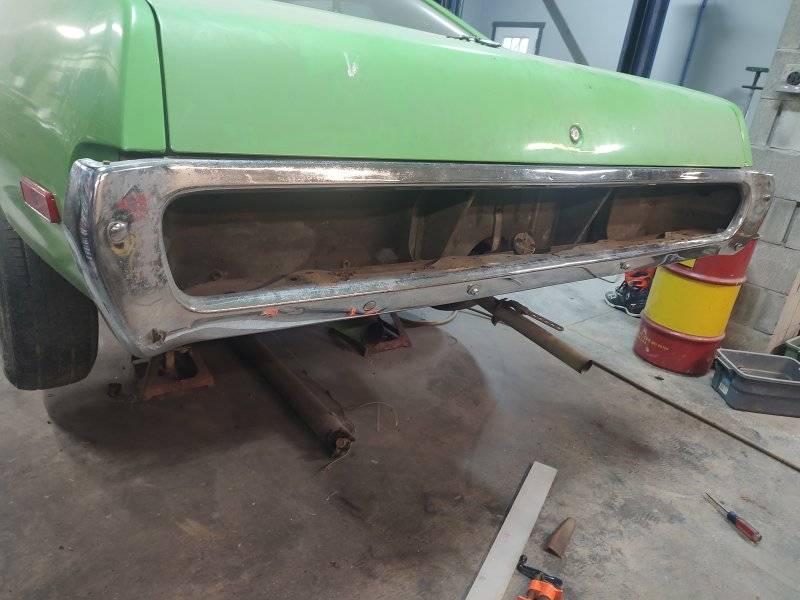

For comparison here's the before pics.

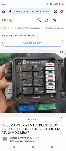

Does anyone have experience with buying power distribution boxes? I've been digging through this wiring and it honestly doesn't look bad at all to wire up but it's clear putting a power distribution box in is the best option. At the very least I need 5 relays and a handful of fuses. I've been looking and there's a ton available on Ebay but likely cheap Chinese crap, I'd really like a name brand option, bussman makes one but it's borderline big enough with 5 micro relays. Can't even find a Bussman catalog to look through their offerings? I absolutely do not want a "prewired" one where I have to make a ton of butt connections but would rather have one that comes with the appropriate terminals.
Here's a picture of what I'm looking for accepted this appears to be prewired for a specific vehicle.

I saw those I'm just a bit skeptical about the quality, the ones I'm looking at are weather tight as well. I've had to many electrical problems caused by poorly built Chinese parts. Here's the ones I'm looking at but it would be maxed out on relays, I'd like to have some extra space.Bussmann Fuse Box, Relays & Power Distribution Modules | High Quality & Wide Range
I am using one of the smaller Bussmann/Eaton units with the 5 relays you mentioned. They are nice units and you can get them with the 12v for the fuses or the 12v to the relay coil bussed internally. I also like this one because it uses the weather pack seals on the connections which I have always had good results with.
Here is a link to the best catalog I could find on the different options they have.
https://www.eaton.com/content/dam/eaton/products/emobility/CPCD_Transportation_Catalog.pdf
