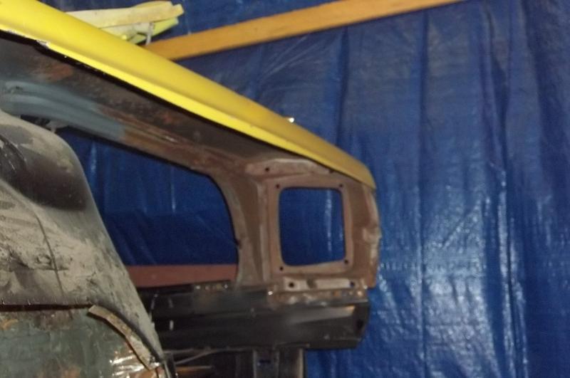

Hi guys, i did say i was slow and have some things going on here but i decided to go to my little get a way and get some work done... ill post these updates for some of it with sand blasting to repairs, I have one part coming from our fellow member Mark (MOPAR MARK, and i thank ya!!!) and today i received a set of turn signal and parking lights that our Will (PROPWASH and i thank ya!!!) and some cheese that i cant wait to get into!! This place never ceases to amaze me with the fellow ship here!

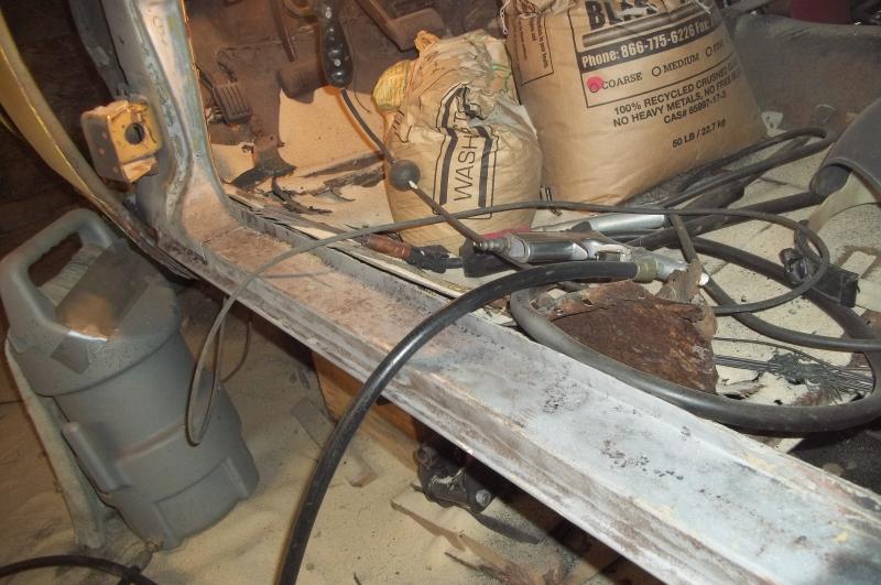

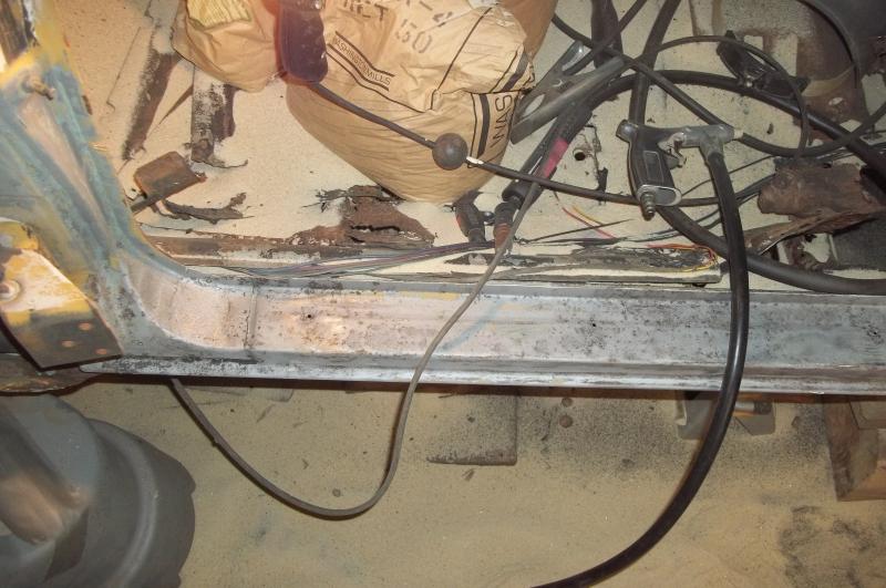

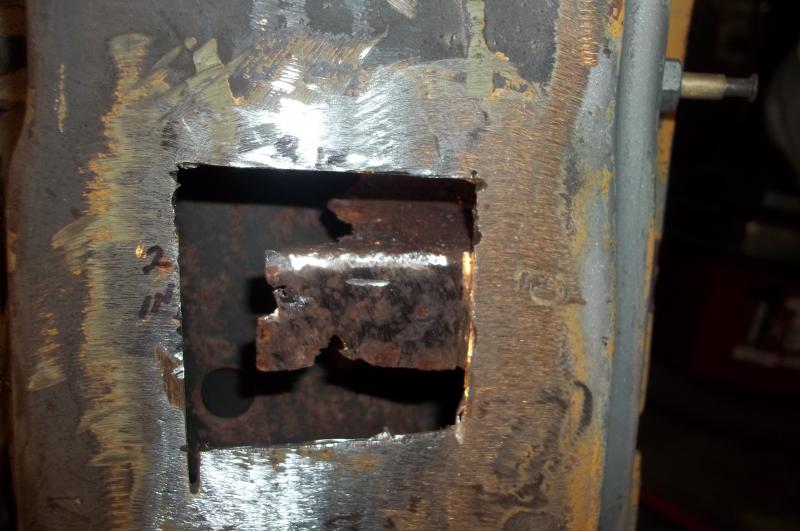

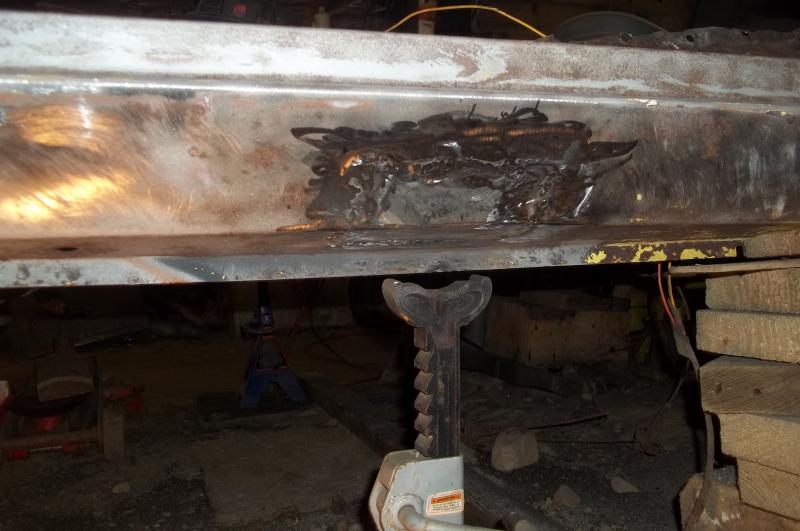

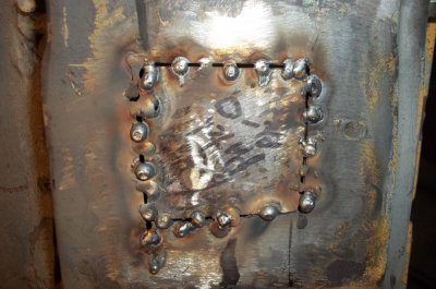

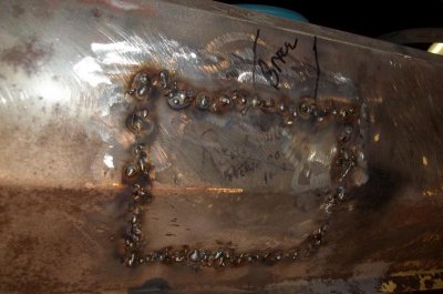

The first ones are some blasting i did to finish up outside and top of d-side rocker panel, I wont know until i get the floor out but reaching up and in on the inside of the rocker, it sure is promising! I will have to replace a floor support, Roger told me it looked bad and peeling back that part of the floor, he was right!, peeling back was using the Blair spot cutting tools, something Will told me about and they are worth the money, i wish i new where, if you can to sharpen them.... The last picture i had already did some work on the back...

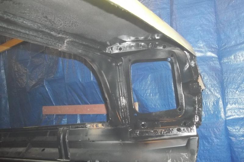

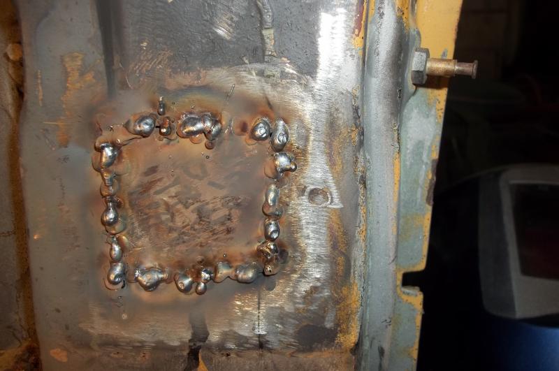

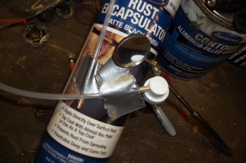

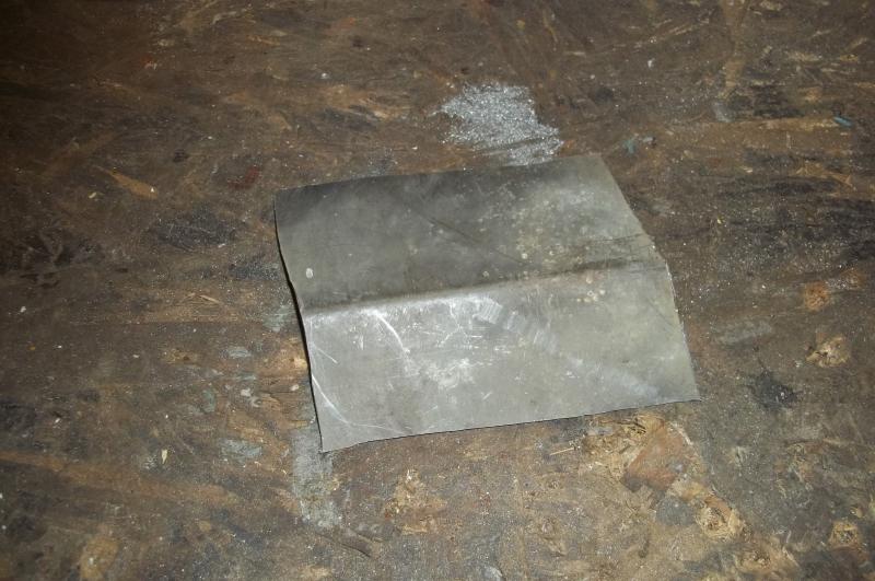

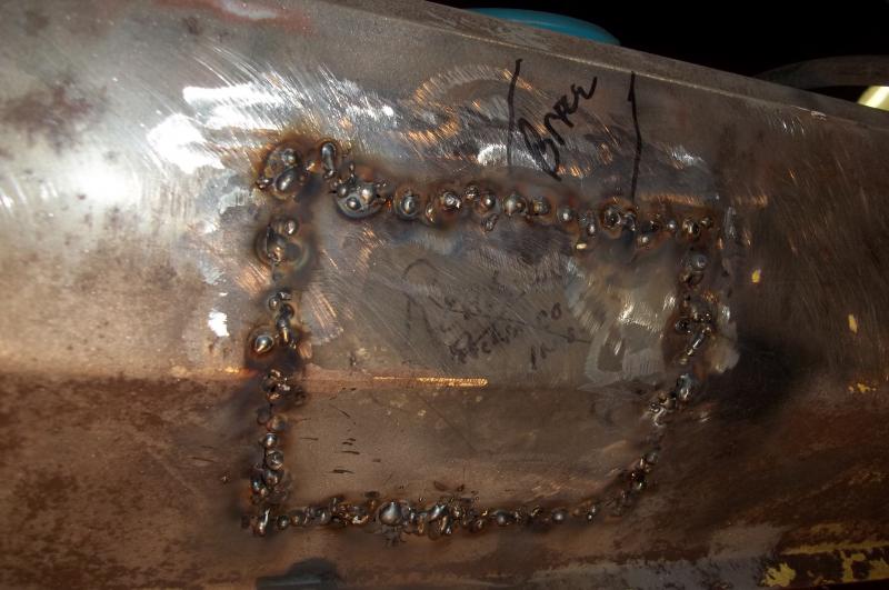

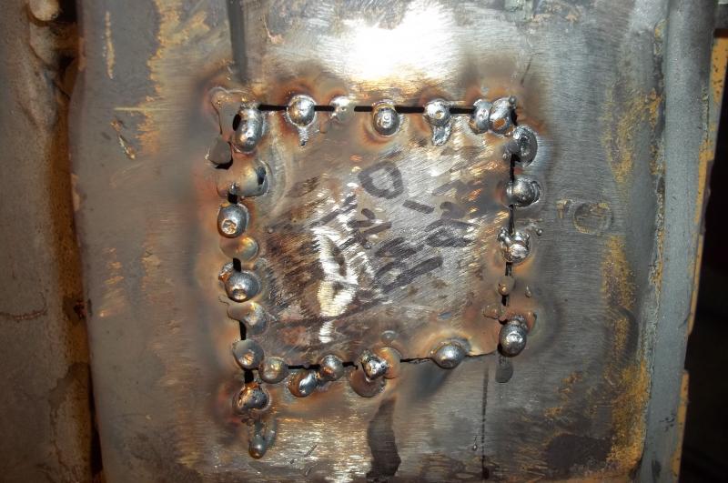

The next ones if i have them right is a bad spot that i cut out and then made a patch to weld in, kind of self explaining but i did clean out the entire rocker (great fun) I had a wire and hook, and used the AC to blow it out but to get it completely clean was a hoot... I have the Eastwoods Rust Encapsulator, supposed to be good stuff for stopping, converting rust permanently, the inside of this rocker is covered and the same stuff did my 1/2 rail i welded into the frame in the back, with that i used a homemade sprayer and line job and it took way more then it should have because the smallest holes i could drill are larger then the fitting at the end of this Eastwoods outfit you'll see, using the mirror worked great here but taking a decent picture of the inside using it, well, it just does not work! And i should say all the sand blasting i did was after i ground down where i was working and fixed this spot, I ran out of welding gas so i had to stop but did take pictures and now its done, im just not sure what pictures i have its been so long, im not used to this part of resto threads lol.... One picture i couldn't help but set Q-skin on and see where i may be cutting later, That part impressed the wife some :) and a couple shots before and after doing the inside of what part of the quarter is staying with Eastwoods rust fixer-uper..

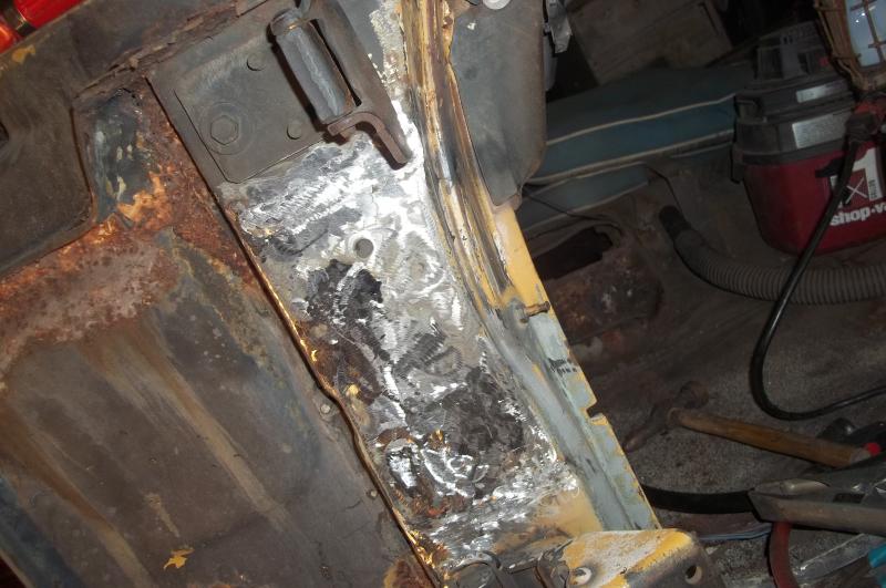

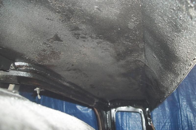

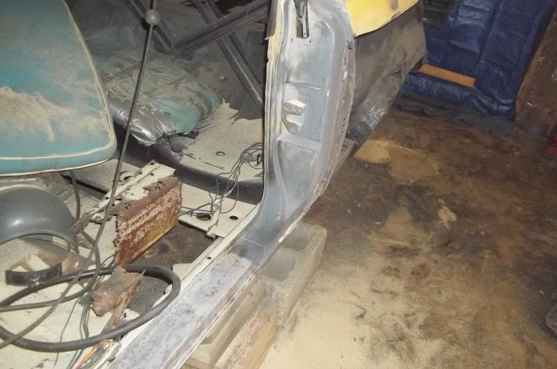

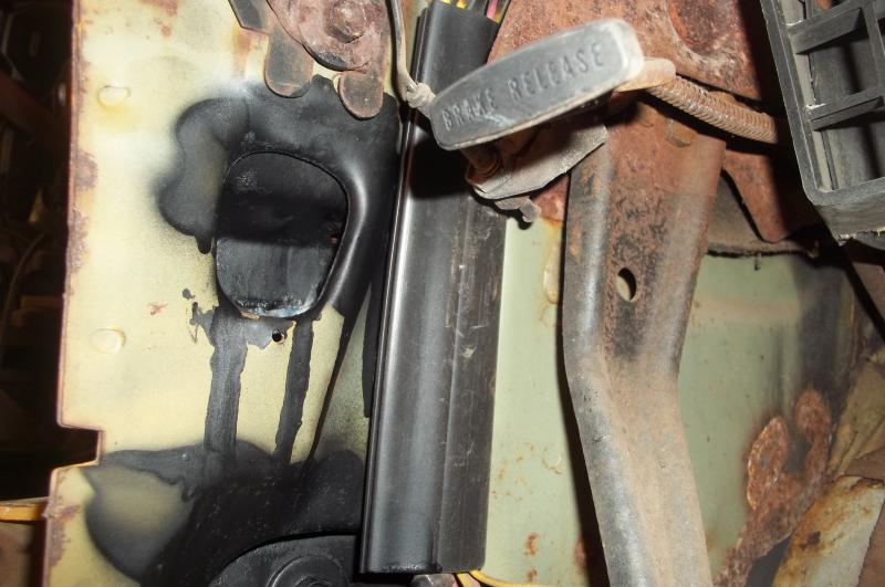

Some pictures at the end is i guess you call it the door hinge pillar, but there was a couple places i thought i had better fix, I did get the inside sprayed with Eastwood and i thought i would include these repairs, I sure hope the inside of the rocker is really good, its the one thing that worried me from the start on a car that truly was put out behind the barn to rot!, It's also what will make this the best thing i have as far as fun, it was on its dieing mode and now its getting lol, probably already more new metal on it then my Kia, i like the idea and the guy i got it from, he lied, he bent me over but im bending back and have his address tacked to my radio room wall and i will Lord willing show him what happens if you decide to make it happen, not happy with him but, I didn't personally go to look at it but explained what i didn't want to have to do, which by the way THAT im doing now, and im glad im where im at with it, heck, a couple more years or so i may get it done! I hope he doesn't kick off before me, he does need pictures of what im doing...

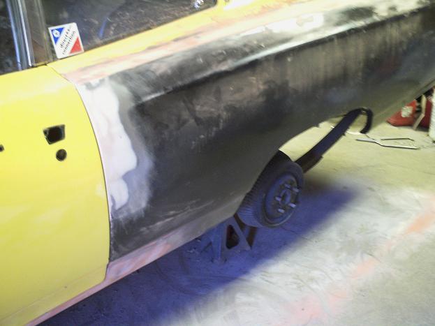

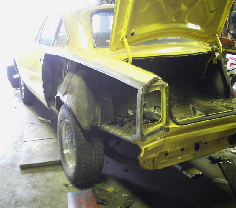

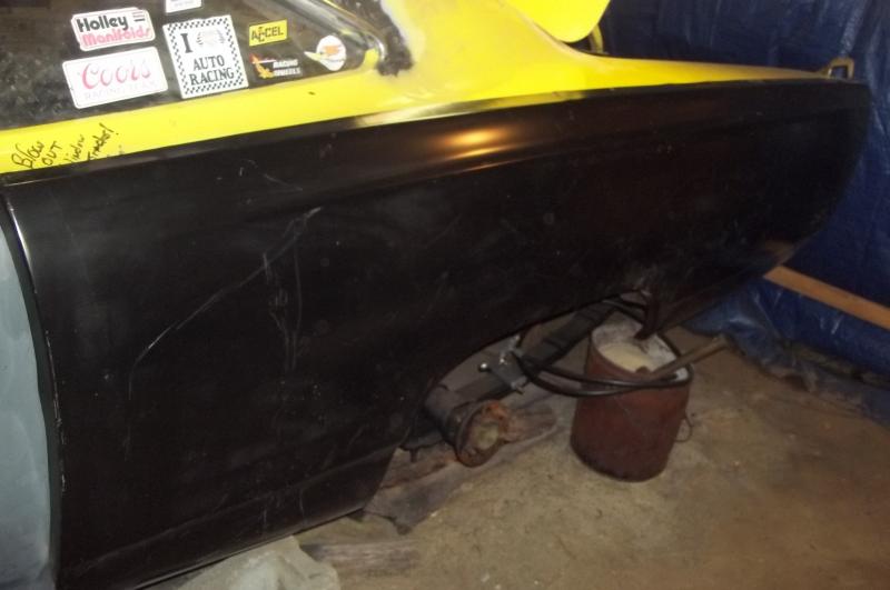

not much looks better or shows more progress than getting that quarter skin on. That pic sure looks familiar though.....

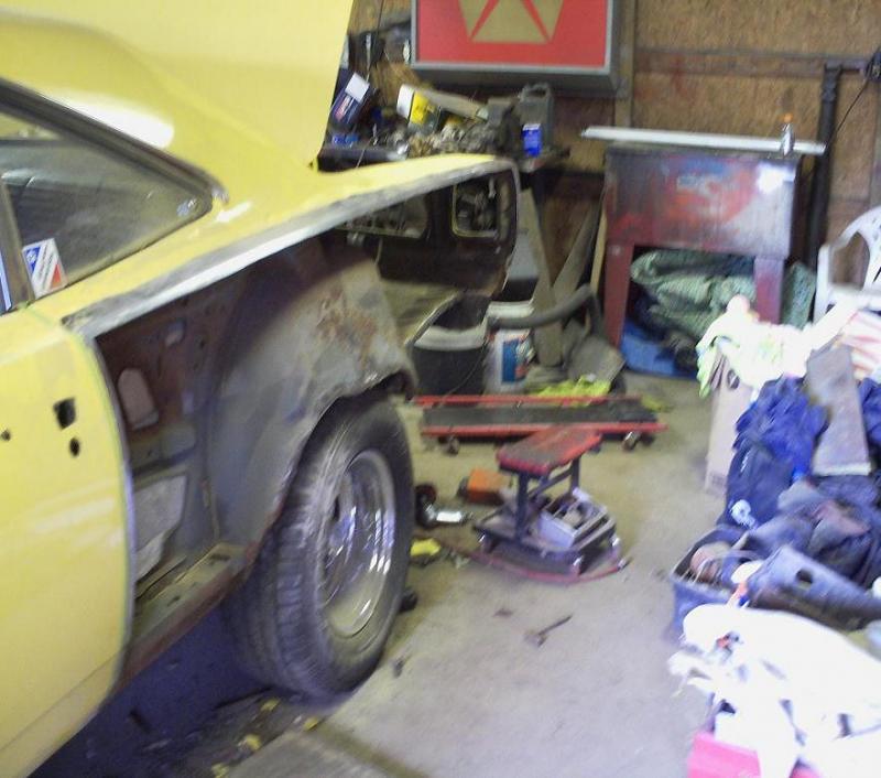

lol, Thats not fair! You have break drums!!!! If i had the room i wouldn't have the springs and diff under there, going to be fun painting i bet, at least i got to blast them outside, i have literately took shovel fulls of sand, crushed glass and aluminum oxide outside from the rest of the blasting ive done, maybe its good i have a gravel floor, cement floor i would be building quite the pile outside where as now the "gravel" drive gets most of it lol.. Thanks Dave...
question, is that from AMD? if so, any problems with it? did you cut the old quarter right where its sitting (top of original)?
the skins were from Year One, and the trunk extensions were AMD, fit like a glove.Here's how my guy cut the quarters.
the skins were from Year One, and the trunk extensions were AMD, fit like a glove.Here's how my guy cut the quarters.View attachment 226254View attachment 226255
