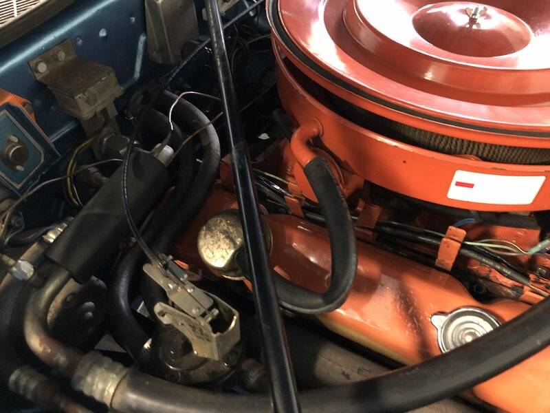

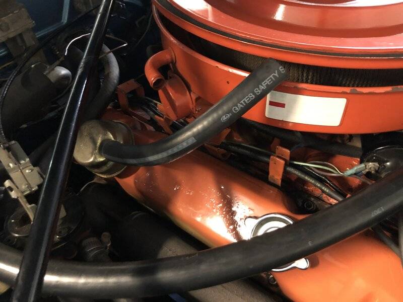

Hi. Does anyone know what the proper breather tube set up would be for a 74 big block? Mine keeps pinching and I think it’s the cause of my dipstick popping up. Thanks, Mike
FDAF0A1B-776E-44E7-AEE9-BEAC4ED9A56D.jpeg 2357E137-211F-4F41-B65E-4130A6459BC3.jpeg
The proper hose is molded so it doesn't kink.
Do you have any idea where to find one?
OR, install a 90° elbow.
Use a thicker walled hose.
Might even try using a heat gun to custom mold the one you have.
