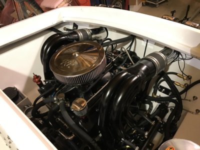

I pull 7 inches of vacuum with a dry sumo on my boat engine.
I also have a pop off valve on one valvecover to relieve pressure should the crankcase ever become positive.
I use a Peterson vacuum regulator.
My system vents through a catch can / breather on my oil tank.

You can see the vacuum relief valve in this pic:
