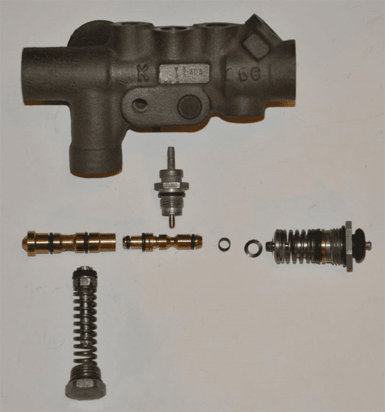

How about you go on line and read the service manuals, and also the Chrysler Master training documents on brake system. You will learn a lot. :thumbsup: Yes the tandem MC was new for 67. Disc brakes also. But drums were drums. No proportioning valve needed. Some vendors misstate and misuse terminology. Distribution block, Proportioning valve, and front hold off or metering valve. Read up: http://www.imperialclub.com/Repair/Lit/Master/index.htm #232 and 233 in the 67 section will help you.
Since you have the distribution block apart, please explain how that simple device can proportion hydraulic pressure? Then google proportioning valve and learn what is inside it and how it works. Now in later 70 they started to combine valves and blocks, and by 71 they did have a single unit that would do all functions for Front disc brake cars. But the 67 and the item you show is nothing more that a distribution block. Attached is a picture of the combined unit for mopar. Look at all the parts.
Ebay calls them proportioning valves....... what ever its called its fine with me.
