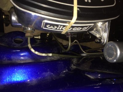

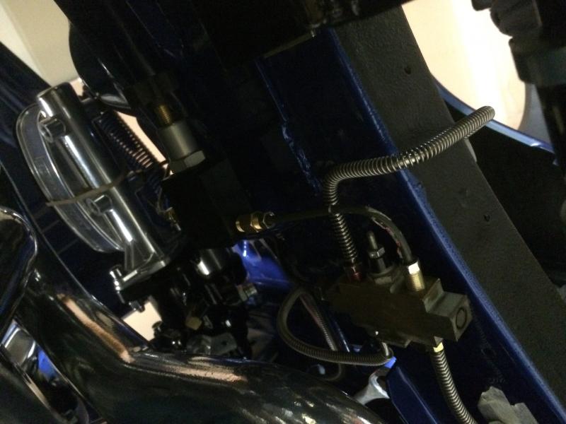

So I plumbed in my proportioning valve. I have the front half of my mc going into the top of my distribution block. The rear of the mc is plumbed into the proportioning valve then into the bottom front half of the distribution block and exiting out the bottom rear of the block.
Bottom line is if it all works. Great to make the things go, real great to be able to stop!
From here all looks good. Your distribution block looks like the same one I have on my disc/drum conversion. It has separate lines going to each front, right? One to the rear.
Some of the later brake set-ups (disc/disc) mounted up various valves in the system for safety add-ons. But, just more junk to leak, or go bad.
Should work for you.
That's exactly the block I have. 2 lines to the front (left-right) and one to the back. I am thinking that the block is like a tee fitting for the front (fluid entering the top and bullheads the fluid to the left/right) and the bottom rear is like a coupler (in/out). This being said with the exception of the safety of the distribution block.

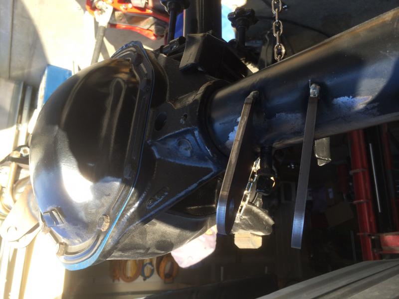

While on the same topic... The rear fitting which is located on the rear diff vent. If I eliminate that ( Y fitting ?) and install a Tee. I should be fine? I don't have the space now and only can fit a short stub for the vent.
Heck! No wonder it won't work...vents on the bottom!! Hehe, or the pic, or housing is up-side-down.
Be kind of a pain to move the vent, but that's one option. Just the way that block is designed, and mounted. No reason a tee wouldn't work for the brake lines. But...on the vent, might need to add a spacer, so it has something to tighten down against. It takes the two copper 'seals' on top/bottom of the block, right?
