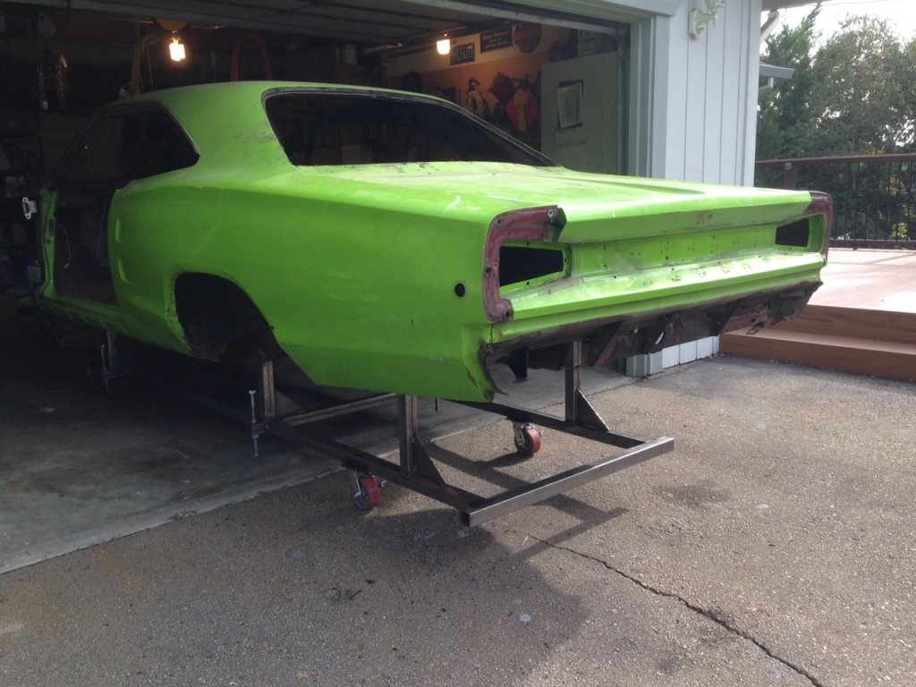

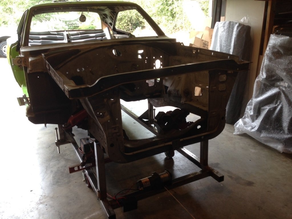

Jim, the Coronet looks fantastic. Great job. I have a long way to go, as mine will need quite a bit more rust repair than yours did. I will be installing new front floor pans, trunk floor & turndowns, torsion bar crossmember, and quarter panels. I am enclosing a photo of mine on the dolly I built to hold it during surgery.
I see you followed approach #2 and painted the car in pieces. I am leaning toward that option, but am interested to hear how more folks weigh in.
