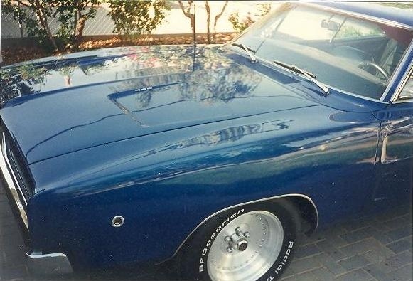

BTW I did paint my first car some 25 years ago in base/clear and it turned out pretty well. Here is my old '68, long since gone:
Take a look at my 1969 Roadrunner Post Coupe Roadrunner
The pics are chronological and it was what worked best for me. If it comes off, it was prepped, painted and polished off the car. The fenders were sprayed on the engine compartment side and bumper side. The bolted in place and were taped / masked off and then painted after final alignment was complete. So basically, the trunk interior was done than masked off. The engine bay interior and exterior. Doors, trunk and hood done off car. Insides first, the flipped and exterior. Car was then jammed out, cowl, and then fenders bolted on and sprayed.
Door and fender alignment checked ALOT before mounting. It's all good fun and that 68 Blue Car looked great. We used base clear and just wet sand it pretty.
Good Luck!
