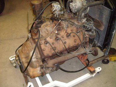

Pulled the trigger on the next one
Well it wont be the fastest car in the valley but the cool factor will be there for sure.
There's plenty of Hot Rod parts for the old flat heads, you can get 250hp :headbang: pretty reliably now, that's at-least triple or quadruple the power of what, they ever were... they had like 50 octane & pretty lousy fuel, back then too... good luck & have fun, keep us all posted

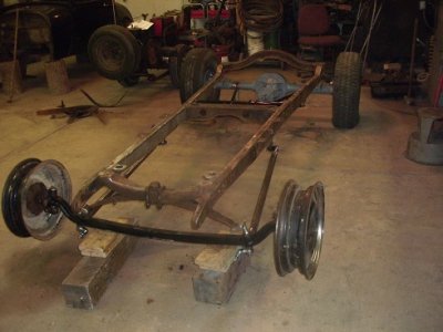

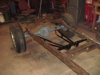

Some progress. Z'ed the rear frame 3".Boxed the frame. Sent the axle off to get a 4" drop,found a 48 F1 ford in the local junk yard for the juice brakes and is pretty much mounted.Rear is a early bronco 9" which is about as narrow as they get from the factory,factory Model A cross spring with a store bought ladder bar setup all mounted.
Looking Good!...Please say you will have fenders:yes:....looks so cool with the chop & drop...:icon_cool:

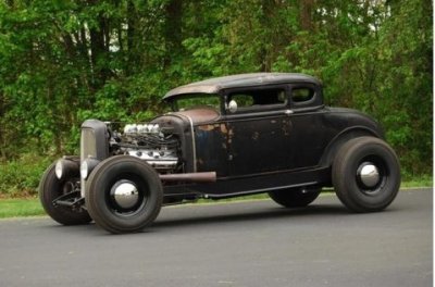

1930_Ford_Model_A_Coupe_Chopped_Hot_Rod_For_Sale_Front_resize[1].jpg sorry its not a 28-29 ,but its a nice looking 30-31

Severe chop looks cool but it aint to comfy to drive.The last A I did it had a 4" channel and a 3.5" chop and with me being 6'2" it was tight.No channel on this one but will get a 3" haircut.
:iamwithstupid: It's real tough/tight fit in a little car like a Model A, especially if your over 6ft, let alone if it's chopped for sure.... try looking over @ www.HotRodHotLine.com , I get there weekly news letter e-mail, some great information, cool articles, show coverage, parts, classifieds & many links there too, especially for Rods of any kind & years....
