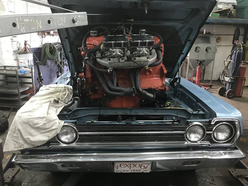

I m glad I found a forged crank from a later year slant six for 50$ . the machine shop is turning it down. now will be able to put my high stall torque converter with lock up
should be getting the crank back tomorrow
looks like Saturday is engine day
Your doing this just to swap in a forged crank? Love the Weber setup!

no I am swapping early version of crank (until 67) the later version of crank end of it where the torque converter goes is larger to accept the lock up high stall torque from the 82 dodge diplomat tranny, on the six the block was changed in 76 when they went to a smaller nodular cast crank

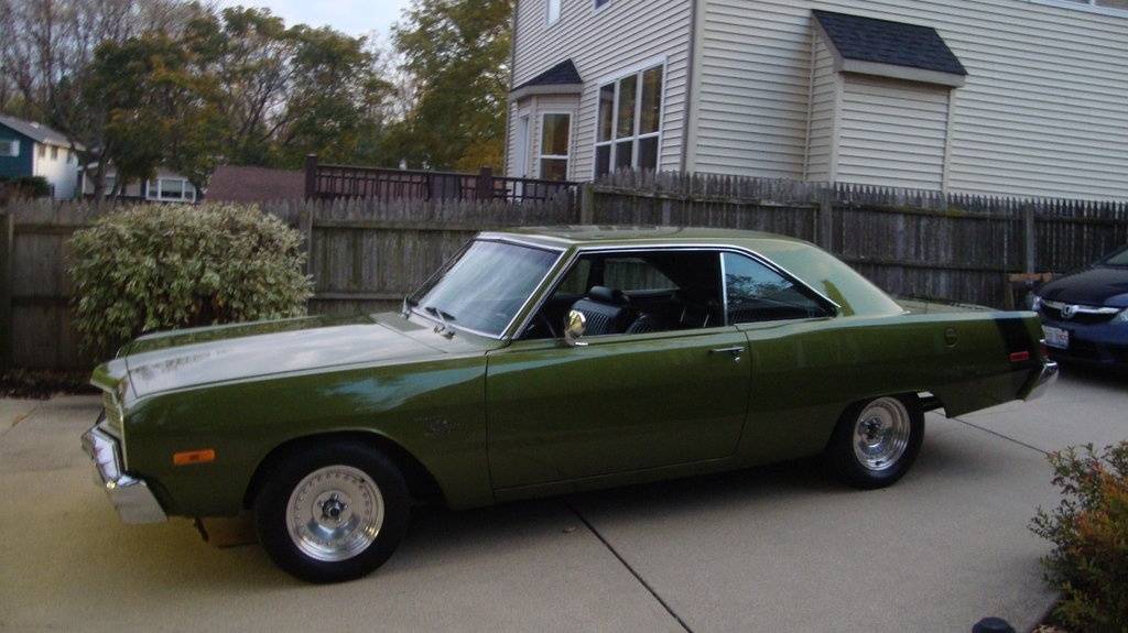

Oh yeah ! 2 of my past A body slants. Been a Slant fan since the first one back in 1970, a new Dart Swinger.

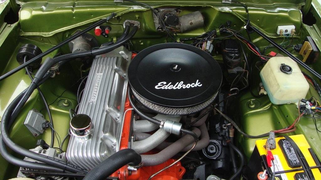

Yep. Mr.Gasket kit from Jegs. It was a drag only car.

Need to do some suspension and exhaust work and she'll be just about perfect.

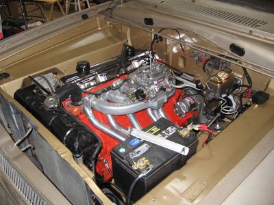

I hope you go with 2-1/4" pipes? Looks like you got split headers and a 4 bbl on there, nice! Mine's stock except for the super 6 and a Weber 32/26 on it, nuthin fancy on my BamBam. See my tagline below!
Ahhh, the leaning tower of power! Had three of 'em - '69, '73 & '76. Couldn't kill them!

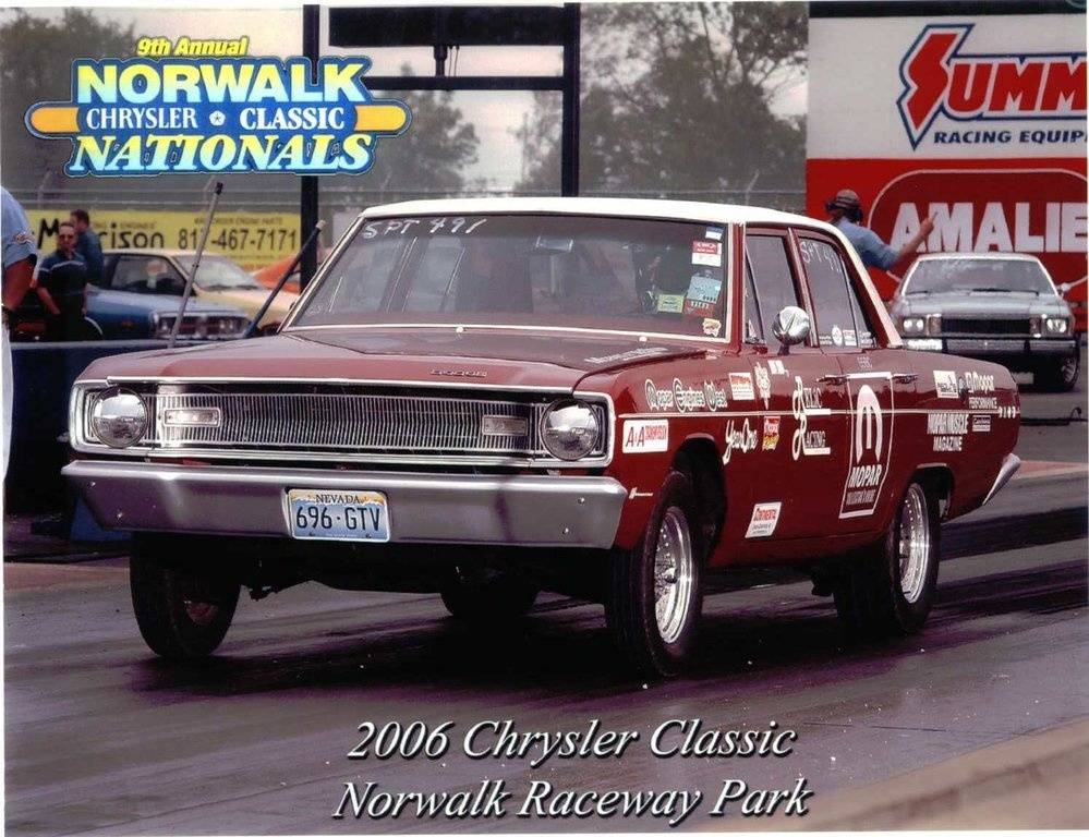

There are some fast ones out there.This one with no power adders would run 12 .90's, all motor,no juice or blow .A friend of mine has his in the low 11's all motor in a 68 Valiant. You can make em' go !
