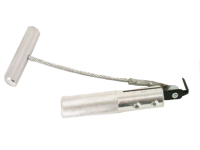

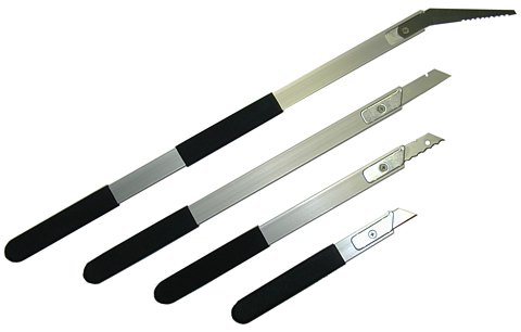

I've been restoring muscle cars for quite a while and i use these tools. The one on the left works pretty good and they are only about $20.00
The 2nd tool in the picture works real good when working buy yourself.
Its real easy to break the windshield with the 1st one. One thing for sure you want the glue to be warm when you cut it. When its cold its like trying to cut rock. GOOD LUCK!
