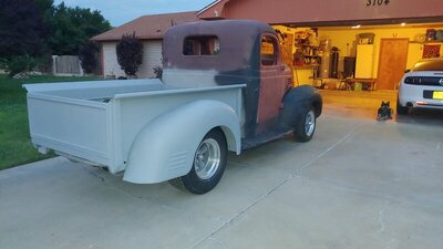

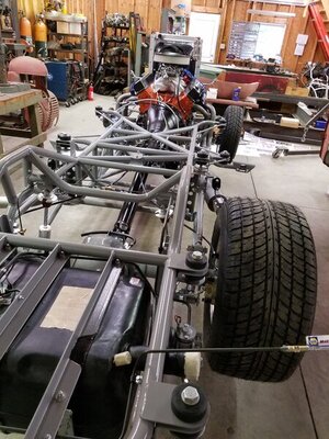

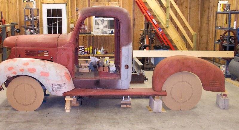

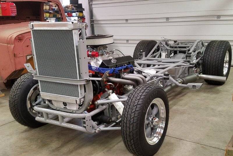

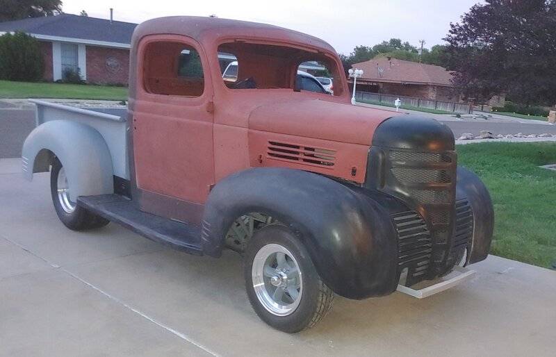

The chassis was designed on CAD by me
and a fellow engineer I worked with. It's
designed to accept the sheet metal from
a 1940 PT-105 Plymouth pickup.
The wheelbase was shortened to 108"
from 116". The chassis has a 4-link rear,
and custom A-arm front. The rear axle
is a shortened (6" per side) 8-1/4 sure
grip with a girdle. (3.55 ratio).
The headers are our design and built
by a local manufacturer. The steering
is via a 90 deg miter box from a bus to
get the steering linkage past the headers.
The rear fenders and running boards
were shortened by 3", and my son and
I also pieced together a 6' bed.
The wiring is near completion, and it
won't be long before it can be started.
I'm getting anxious to hear this thing
run.
