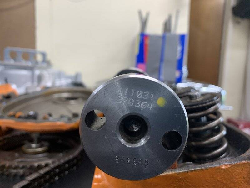

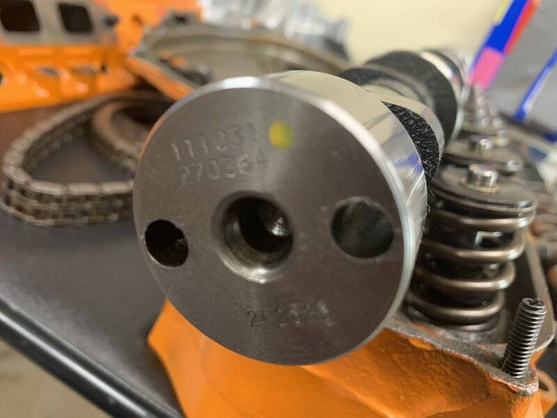

Need help identifying this cam I hope someone can help
Thanks Tom

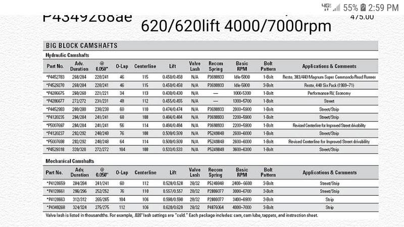

Measure cam lift times 1.5 to get close to the valve lift.
That may help you.
That may help you.
Yep, an empty motor block, a dial indicator and a degree wheel and you can easily identify just about any cam. Then, don't lose the cam card you create for it lol.
