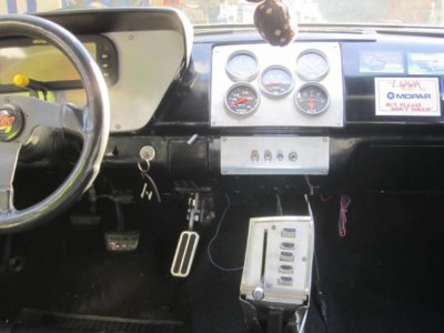

I'm using a '65 cable shift, slip yoke BB 727 in my '63 330 build. I was told by a Reliable Source, my PB cables will fit right in. Welcome ALL comments...
I will NEVER give up my pushbuttons!!!:usflag::drinks:
