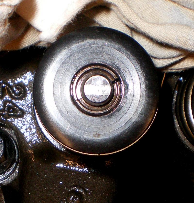

thanks to all. I think I got it going my way, here is the 'witness' mark on valve stem, you can just see it 1-IMGP0154.jpg
That's what you want to see! Now we all know 440 Source rocker at least have the proper contact.
geometry at the valve looks good. i just started doing something different on the valve tip geometry check. i've been bench testing some heads using typewriter carbon paper. it works.
It's centered, thats a good start...however it may still not transfer the cam lobe perfectly, but don't fret...most of our stuff is never EXACT anyhow.
Check out the B3racingengines website and read their geometry write up and rocker shaft kit that fixes it all.
Remember the pattern on the valve stem is wide cause the roller is moving across it.
