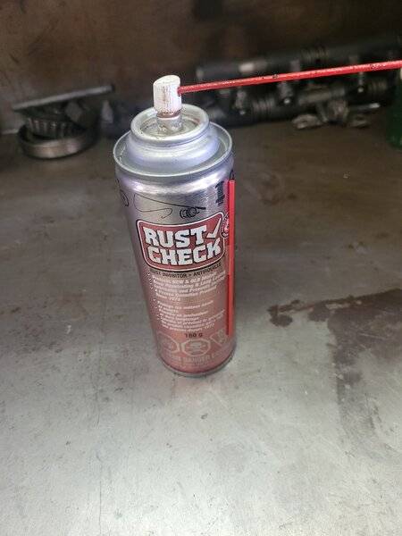

Thanks appreciate it motor been sitting for long time wrapped up with no oil so I was thinking of spraying wd into plug holes and letting sit overnight then filling with oil then I can try and hand crank first

So it's a fresh rebuild, but not finished? I would use rust check in the cylinders if rust is a concern. Don't worry about oil pressure when hand turning.
