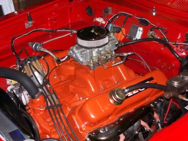

You need a fuel line like I have on my 63. The chrome line takes a 90 degree turn where the fuel line hooks up. Clears the dist fine. Ron
