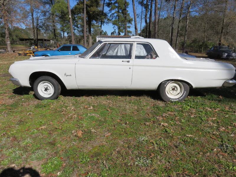

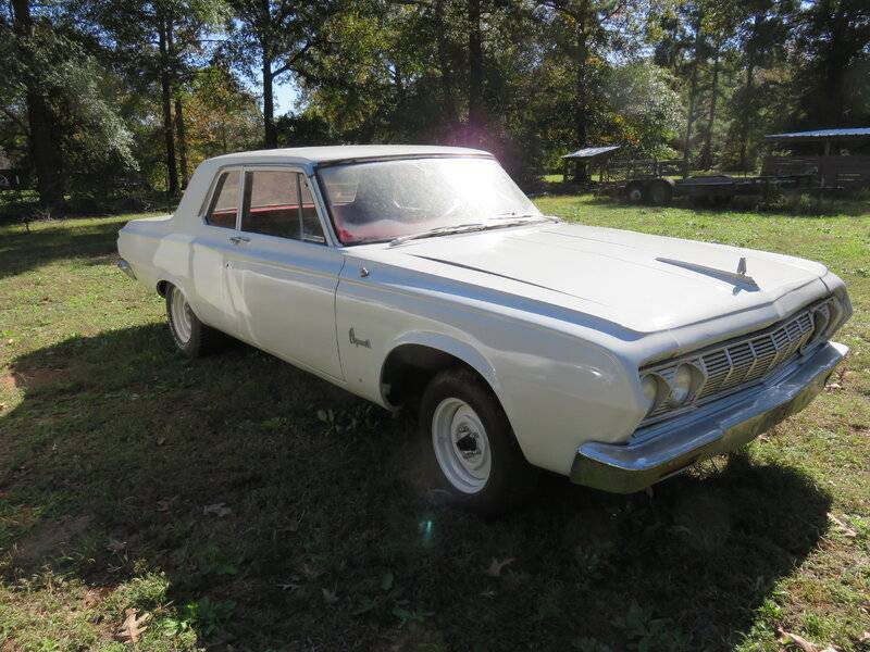

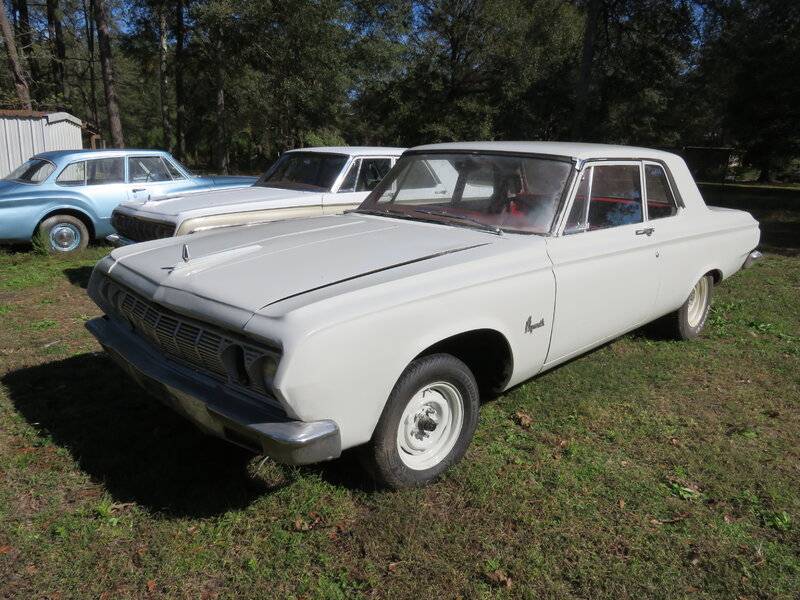

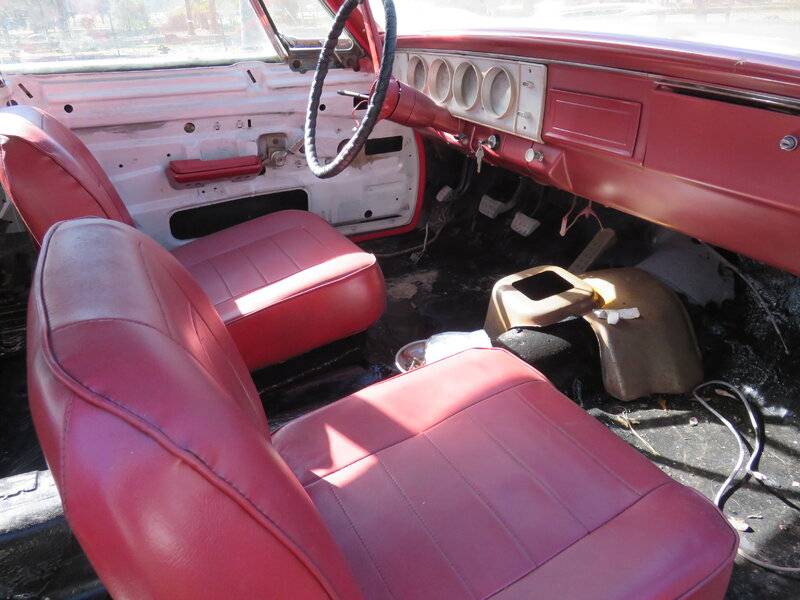

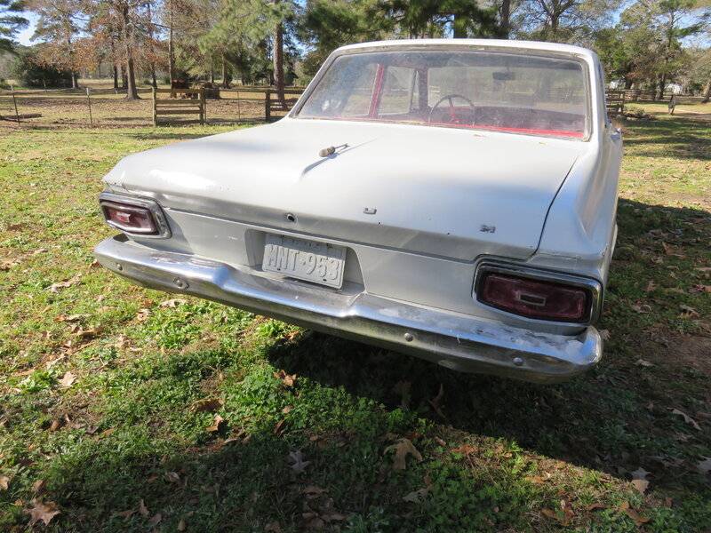

It is originally a slant, 3 on tree heater delete car. The buyer can add AC if he wants, I am going toward the SS style look.
I agree it is always worth more running and driving. Period.
IMG_0104.JPG IMG_0065.JPG IMG_0066.JPG IMG_0071.JPG IMG_0072.JPG IMG_0086.JPG IMG_0101.JPG IMG_0102.JPG IMG_0103.JPG

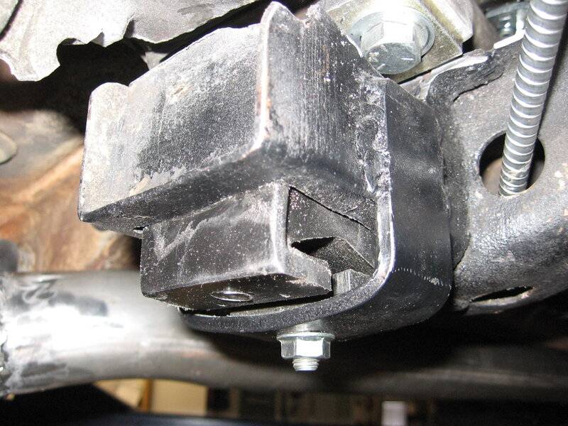

I did what you are planning with my 63. Just something to drive around having a 1970 318/904 combo from a Coronet that went Big Block.
I used the 63's poly K frame and Schumacher mounts.
I did have to do a little work on the transmission mount using one from a a-body cutting and welding the cross member mount area.
Found a extra cross member on here for $30 so if plans change and I go Big Block/727.
The car was build for fun and using mostly left over parts from many other projects from over the years.
