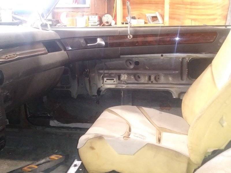

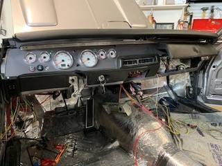

I just recently assembled the drivers door guts & glass on the Express because I created custom door panel interior sections that involve Audi A6 door release handles up at the top front of the door, about where the forward fastener would be on Coronet 500 door emblem. So the latch rod was very different and I needed everything in place to judge clearance issues and routing issues for the rods, tilt out cubby and CD controls in the bottom 1/3rd of the door cavity and the wiring harness from the Audi doors. Admittedly I had the door off and on a table until everything was in and then hung the door to be sure getting vertical didn't change anything. It's fun working through square holes with sharp edges!
That will be awesome ghost Ghostrider! My dash is modified also but no where near THAT extent.... ,you have taken your build to a waaaay different level. Mocajava
