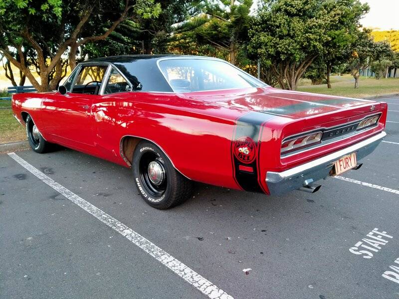

We are replacing a few front end components to get our coronet road legal here in n.z. and shocks are one of them.
I've had Bilstein in my fury for many years, and they are good, but I have been looking at the single adjustable qa1 for not much more.
I have Mopar performance .96 t/bars to go in front, and it has h.d. leaves on rearso, what do we think, qa1 or Bilstein?

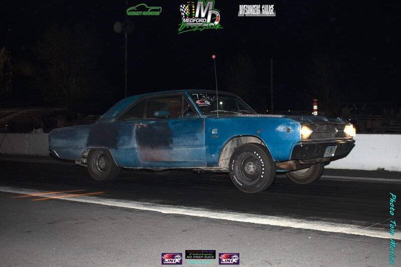

That said I am a big QA1 user and a fan of thier products. Made in the USA with excellent tech support. My stick 68 GTS has single adjustables with stocker star R's in front. Tire is a 235-60-14. 5k launch with some spray on an unprepped surface:
