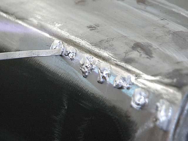

If you use lead to fill which is far better then bondi file it with flat file soaked in transmission fluid to keep file clean and no dust in a cross hatch
You can use lead. but the fumes will reduce the number of brain cells that you have! Use pure tin
and an acid flux to seal any pin holes you may have missed with the welder. I used an old-time copper
ended soldering iron and a propane torch to solder my eight foot long Butt weld shut. You can find one
on Flea-Bay.
Your over worried about lead and using tin only is not a solution. When using lead you clean it really good then you use a combo of etch and tin to prep surface. Once you tin the surface you use a rose bud torch and apply a 70/30 blend of lead bar using a wood paddle to surface. Once this is done you never grind lead. Sure some idiots will do it. The correct method is use a long file dipped in transmission fluid and file the lead.
