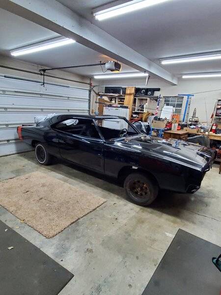

Starting to put this 69 back together got the new weather stripping. Wondering about installing the inside weather stripping it came with staples I've seen them before but have not installed them, and don't have a clue, I'm thinking pop rivets but would like to do it right

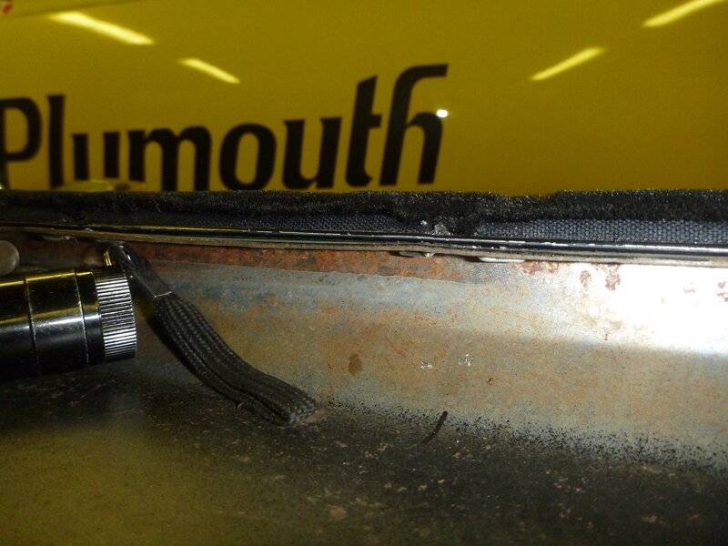

Rear quarter inners are stapled to the removable trim plate...at least on a Runner. Not sure about a Charger. Many guys rivet them or use small #4 screws to hold them in place when restoring, but no reason not to use the supplied staples.
Drill new holes and insert staples.

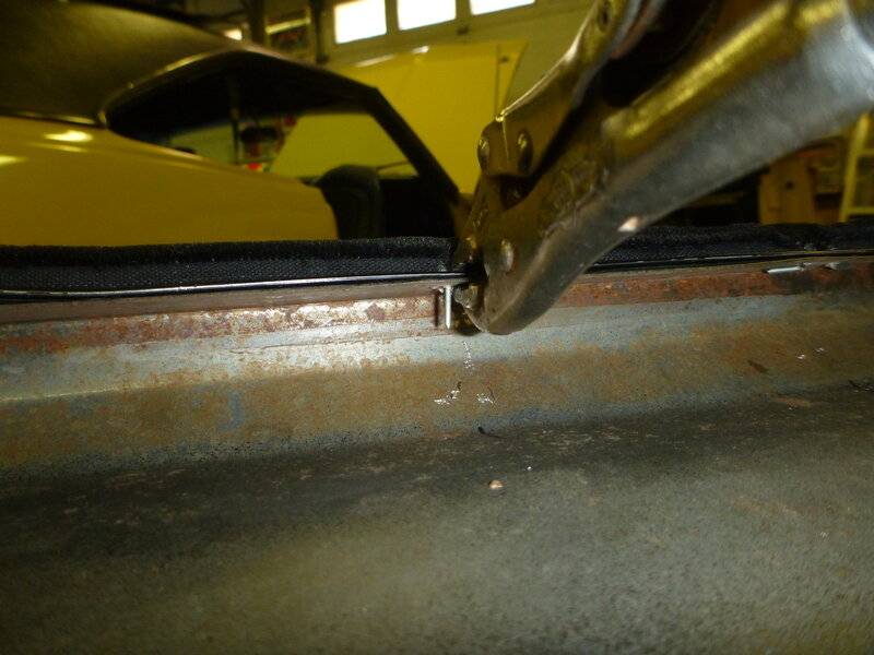

Clamp staple down with vice grips.

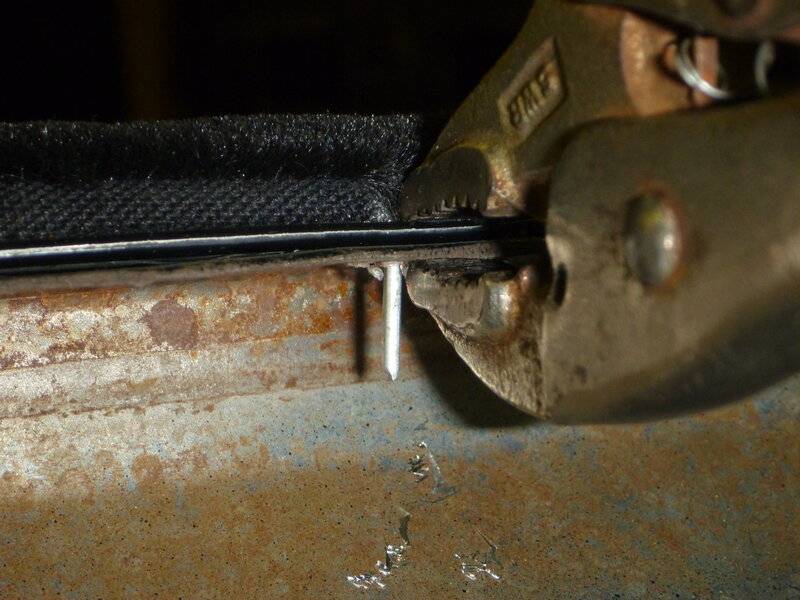

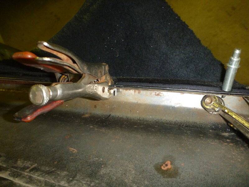

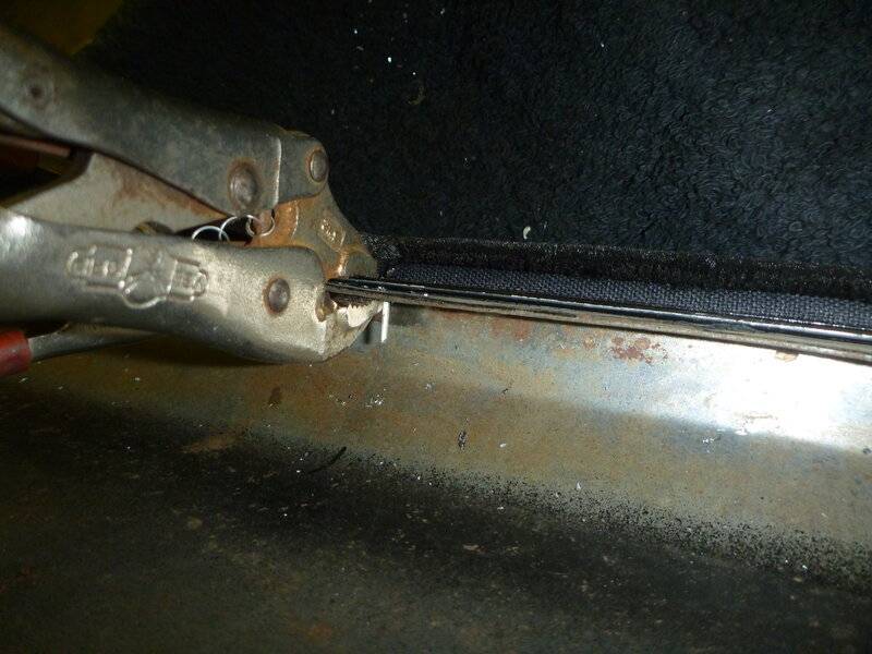

Factory are bent inward, but this is the easiest, bending them out, while clamped in place with the vice grips.

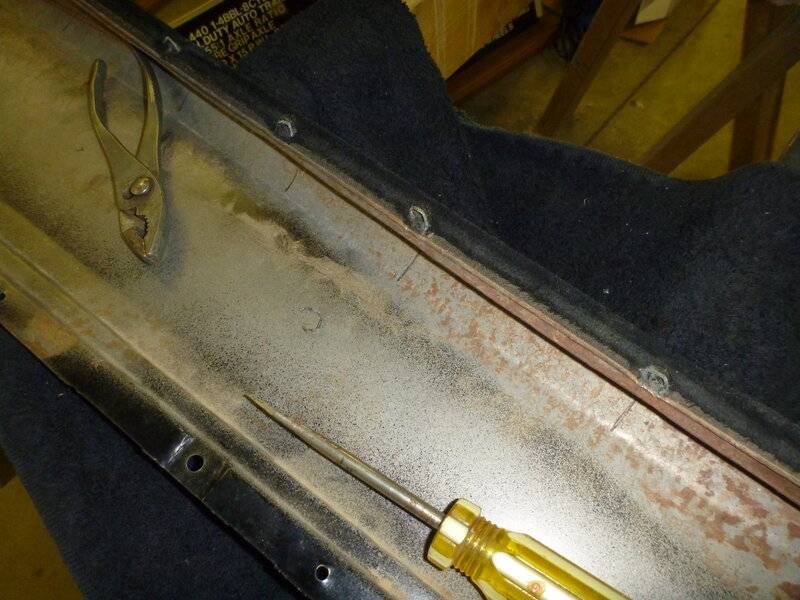

Removing the old.
